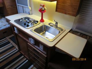

Posted By: marwayne
Date Posted: 15 Jan 2019 at 6:36pm
https://postimages.org/">
