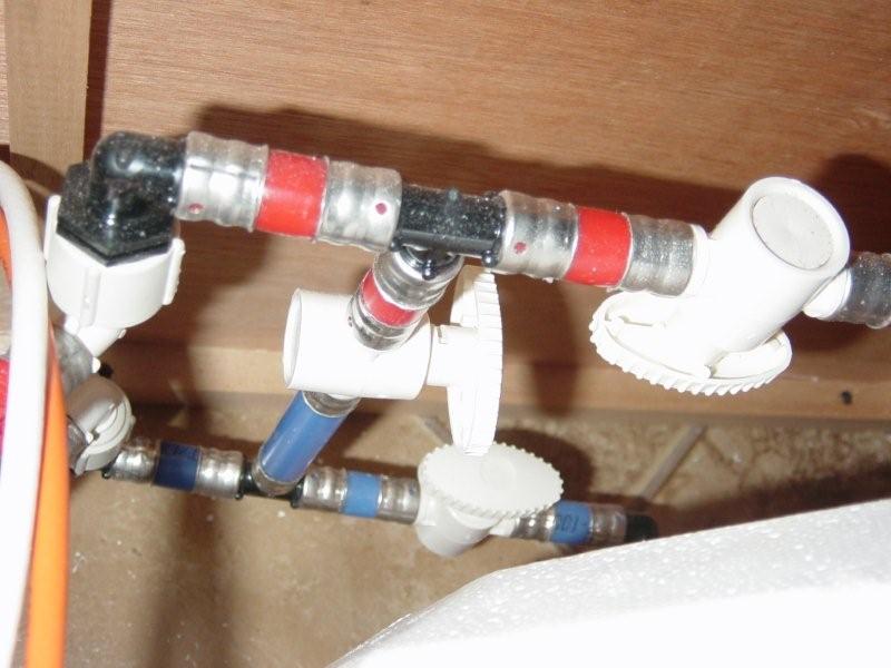

Posted By: TrinityTurret
Date Posted: 22 Oct 2013 at 1:59pm
I THOUGHT I had it all figured out...
Note that after I drained the water heater and put the rod back in, I did the bleach-mixture-fill-the-fr tank- procedure; Couldn't get water thru the hot water tap fixture until I OPENED the middle valve. Now I'm all confused. Please, someone explain what function each of the three valves have in this photo, and I shall be forever grateful :)
There's only one way...
Posted By: furpod
Date Posted: 22 Oct 2013 at 4:43pm
In the picture you have shown, the two open valves allow water to freely travel through the WH, and the closed one on the bypass, keeps it from "shorting the circuit".
When you reverse the positions of the valves, the water stops, and turns around through the "short" instead of entering the WH.
Why were you sanitizing the system at this time of year? (just curious..)
Date Posted: 22 Oct 2013 at 5:20pm
Why, when I OPENED the middle valve, did water then flow through and come out my hot water faucet after I had filled my fresh water tank? It didn't seem to come out but 'air bubbles' & wheezing noises when I had that middle valve closed?
Second part of this new question...when I winterize...I take it, then, the valve going IN to the heater, and the one coming OUT (the top and bottom valves) should be CLOSED, to prevent the antifreeze from entering the WH. I assume the middle valve should be 'open' to allow antifreeze to 'go around' the water heater---it really 'bypasses' the VALVES, and not the heater, because the valves are keeping antifreeze from entering the heater, right?
Posted By: furpod
Date Posted: 22 Oct 2013 at 5:37pm
Because you created a shortened path for the water to follow, so it wasn't trying (as hard) to refill the WH. The blowing and wheezing you were experiencing was 6 gallons of air being pushed out of the empty WH by the incoming water.
Well, yes.. but you don't bypass the valves.. you are forcing the water to BYPASS the WH. BTW, you CAN winterize, with antifreeze, without bypassing the WH.. It's how it was done "back in the day".. you just needed 10 gallons or more of anti freeze, so you could/would fill the WH..

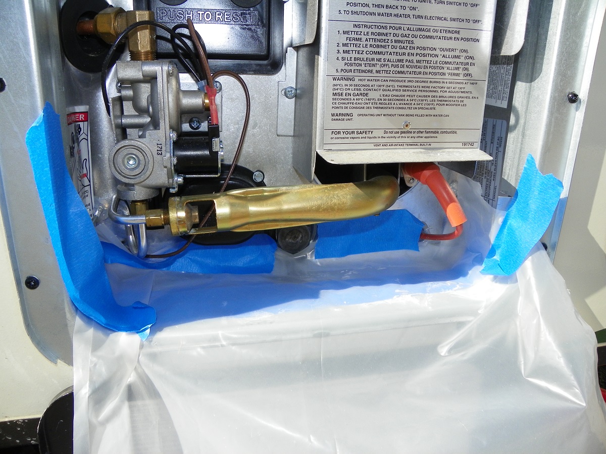

Date Posted: 23 Oct 2013 at 3:42pm
When I remove the anode rod, the water pours into grooves of the outer rim..and seeps down along the inside of the Rpod, actually seeping out the sprayed-on foam around the low point drain. Is there any way to avoid this other than my ridiculous visquine and masking tape?
Date Posted: 23 Oct 2013 at 4:56pm
I noticed the anode rode hole is about an inch above the bottom of the heater...thusly, there is still about a half-inch of water in the heater. Will THAT AMOUNT of water cause any problems should it freeze up? If so, without some kind of pump, I can't get all the water out...
Posted By: kymooses
Date Posted: 23 Oct 2013 at 5:59pm
Never has caused a problem in ours.

Ah yes, the mystery hose. That hose is used during winterization. It is connected to the input of the pump and allows the pump to suck antifreeze into the water system. If the hose is left hanging and the valve is switched to it the pump will suck air. Hence your experience. Before de-winterization the valve should be switched back to the fresh water tank and the bypass valves reset to normal operation. If you have a few days search this forum for winterization and enjoy your read.

The way I have done it since purchasing our RP179 is to have the three valves set so that the top and bottom ones  (hot water and cold water valves) set to open (parallel to lines) and the bypass valve (in between the lines) closed. Either with the water pump or with a city water connection, the water heater tank will start to fill, but there will be air in the tank that will need to be vented. That can be done either by opening a hot water faucet or by opening the pressure relief valve at the top of the tank on the outside behind the cover. Don't turn on the water heater until it is full. This mainly applies to the electric water heater because the element can burn out in a matter of seconds if there is no water in there.
Posted By: furpod
Date Posted: 16 Aug 2018 at 7:36am
"open" is "parallel".. The "owners manual" is a generic thing.
On some rigs, (no Pods that I know of) there is in fact, only one valve, a few pods have shown up with a 2 valve system, but by and large, Pods have a 3 valve system. Tech's notes are for that system.

Once we brought our RPOD 180 home from winter storage, it was home 3 days and then water started coming out from underneath the water heater.  Does this mean that the water heater is puched? Can if burst by sitting there after 3 days, could it be something else?
Lina Scott
Posted By: GlueGuy
Date Posted: 11 May 2020 at 7:52pm
Did you maybe forget to empty it for winter storage? If it had water in it during freezing weather, you may have a cracked/burst tank. Just guessing without more information.
Posted By: offgrid
Date Posted: 12 May 2020 at 6:07am
Two questions:
If the water heater was drained for winterization by removing the anode rod (only way to be sure to get all the water out) then was it fully tightened back in the tank afterward or left loose? I would check that spot first as many folks leave the anode rod loose over the winter so any residual water can drain out. The anode rod is the thing that looks like a bolt head at the bottom center of the end of the tank you see when you open the outside cover.
Second, have you confirmed that the water is actually coming from the water heater? There is of course plumbing in that area as well so you should hunt for the actual leak source before doing anything else.  You might have to pressurize the system and refill the tank again to find the leak. Once you do, drain everything again like you are winterizing so everything can dry out.
If you've confirmed its the water heater, not the plumbing and not the anode rod hole but the tank itself, then you are unfortunately going to need a replacement tank. They cost around USD 300-400 but aren't  that difficult to replace.
Good luck!
