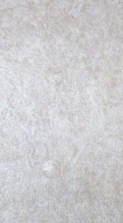

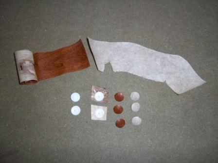

Though the medicine cabinet looks nice, it is totally impractical for brushing your teeth. We just took ours off the wall, took the mirrored door, removed the handle, and hung the door back on the wall with command strips. Changes everything. Have to figure out how the cover up the screw holes in the wall which I will. Am also replacing the faucet.
Posted By: marwayne
Date Posted: 21 Oct 2020 at 11:05pm
https://postimages.org/">
Posted By: cfishkin
Date Posted: 22 Oct 2020 at 8:59am
Wow, my first post and what a reply.  Thank you!
