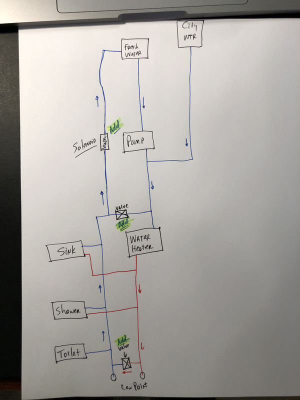

All, I'm developing a plan for normal use of the cold water systems in my 179 during freezing conditions.
Yes I know that you can dry camp and/or use RV antifreeze to mitigate freezing issues, but that is not the objective here. And I'm not trying to create something that would work at sub zero F temps, my target would be around 10-15 F/-10 C. It never gets colder than that where I live or would plan to camp. I just wanted to get some thoughts on my concept prior to proceeding, in case I'm missing something, so if you're willing to take the time to read through what follows I'd appreciate it.
Obviously, a heating system would be needed for the fresh, black, and gray tanks and their drain lines. And also, it would be necessary to maintain the temp above freezing in the rPod interior as well. That's easy, there is a furnace for that purpose when off grid and a cube heater can be used when plugged in.
The typical way to heat the tanks in the RV industry is to either enclose and insulate the bottom of the RV and blow warm air through it to maintain tank temperature, and/or to use heating pads for the tanks and drains. I don't want to do either of these things for two reasons. First, electric elements are out for me because I rarely if ever camp with hookups and electric heating uses far too much energy for off grid use.  Second, I think it would be very difficult to create an enclosed insulated space under a pod that was both sealed against external air leaks and would also have enough space around the tanks for warm air circulation.
So, I want to instead heat with hot water from the water heater. The heat source can then be propane while off grid and electric when plugged in at home, as that is already in place. My plan is to install a small 12Vdc circulator pump between the hot and cold water lines, as is done all the time for instant hot water systems. The circ pump would provide a small pressure differential on thermostat demand to heat the tanks via the hot water lines, with return via the cold lines. As a bonus, the pressure water lines would also stay warm just as they do in a home instant hot water heating system.
To transfer heat to the tanks and drain lines I would run probably a 3/8 copper line inside each drain line from directly behind the dump valves up to the elbows where the drains enter the tanks. That would provide for direct heat exchange to the water in the drain lines which would in turn circulate by natural convection (thermosiphon) to the tanks. I would change out the 1 1/2 in gray tank dump line for a 3 inch one while I was doing this both because the small pipe is I think too small to support a good thermosiphon loop and just to have the two heat exchangers be identical. Besides, that line drains too slow now anyway.  I would just make up two new complete drain assemblies so I wasn't fussing around with stinky old drain lines. The copper lines would be placed against the upper inside surface of the drain lines both to enhance the thermosiphon action and to not interfere with solids drainage. FR conveniently provides low point hot and cold winterizing drain lines adjacent to the two tanks to connect the copper lines to using pex.
The fresh water tank would need to be done differently both because the pump feed line needs to be protected and because there is no large opening to connect a thermosiphon to the bottom of the tank with, so for that tank I would use a thermostatically controlled 12V solenoid valve and simply feed hot water into the tank drain line when the tstat called for heat. Very little hot water would be needed for this, and the feed line to the pump would get warmed simultaneously whenever the solenoid valve was open to replace the water entering the bottom of the tank.
Of course, I would still have to insulate the bottom of the pod and the drain lines to reduce thermal losses but I could just use a closed cell foam spray kit for this as I'm not trying to make an air chamber.  I would also install cutoff valves for the outdoor shower to winterize that, I don't see taking outside showers when its freezing out Thumbs Down
The spray foam kit would be most of the cost for this mod because all the other parts are simple plumbing parts and a low cost water circ pump and solenoid valve. The little 12V digital thermostats (I would need 3) are about $10 each on Amazon. I think the whole thing could be done for probably less than $500 and would greatly expand the utilization of the rPod.
If you got this far thanks for taking the time and I'd appreciate any constructive feedback.

I made similar mods to my Camplite 21RBS. I utilized the onboard WH and the existing onboard pump with a timer to circulate HW throughout the piping system.All exposed supply piping was first insulated. Careful examination of the existing plumbing reveled the exposed hot and cold pipe runs were adjacent such that I could wrap most runs in a common insulation. This allowed the circulating hot water to heat the cold water pipes as well. A timer controlled solenoid valve took HW from the furthest fixture, the kitchen, and dumped it back into the FW tank, thus heating the FW tank. I didn't treat the waste tanks since they are more easily handled with antifreeze. The attached links may give you some ideas for you project. Your concept of circulating HW from the existing WH is sound and an excellent starting point. PM me if you need more details.
https://aluminumcamperforum.com/index.php?topic=314.0 - https://aluminumcamperforum.com/index.php?topic=314.0
https://aluminumcamperforum.com/index.php?topic=255.0 - https://aluminumcamperforum.com/index.php?topic=255.0

I read through your links and found them very useful. I have a couple of questions.
Looks like the solenoid part of your system is very similar to what I plan to do, other than I'm thinking of using a thermostat rather than a timer and will be dumping the water back into the fresh water tank. How did the timer work out for you, did you do any testing to determine your cycle times? Did you consider a thermostat and if so, what made you decide on the timer approach? Also, do you recall what solenoid you used?
I'm planning to use the solenoid only to heat the fresh water tank and the pressure pump suction line (because feedwater would return to the system through that line whenever the solenoid was energized).
For the hot and cold water lines as well as the gray and black tanks I'm planning a circulator pump, just connected between the hot and cold lines at the water heater. This is where the circulators are usually placed in residential instant hot water systems. The circ pump is left running in those (its tiny) and generally a temp sensitive wax valve is placed across the hot and cold lines at the farthest point in each plumbing loop. This keeps both hot and cold lines warm. I basically want to substitute the tank drain heat exchangers I plan to make for the wax valves and turn the pump on and off via a thermostat(s) to save energy rather than just leave it running.
Looking at the way the rPod's fresh water plumbing is laid out relative to your Camplite one benefit of the rPod is that all the hot and cold feed lines are inside the camper except for the two sets of low point drains. If I tee off the hot and return to the I think that should keep all the fresh water plumbing warm. Do you agree?  My biggest concern was the low point drains themselves which would have to stick out of the insulation a little. It sounds like you had the same potential concern but never had a freezing problem at those points with your system?
Thanks again!

I was going to lift the trailer, reroute lines through split plastic wire loom so I could access them and pull them through later, dress up in a moon suit, and spray the whole bottom of the trailer using the two part foam kit. I should have plenty in the kit to do everything. Can't use open cell hardware store type foam, that holds water. Anything left over I have some places in the attic to seal up.
Thanks again!
OFFGRID,
I did consider a thermostat but settled on the timer as simpler and adequate. The thermostat would need a remote sensor and I couldn't decide on where to put it. Simply sensing outside temperature would waste energy but I couldn't decide where in the network of insulated pipes would be the most vulnerable. Also the thermo controllers were more expensive; the timer was amazingly cheap.
My experience with subfreezing temps to date is very limited so I haven't experimented with cycle time. The timer has a minimum run time of one minute with 17 settable events. I set the timer to turn on every 45 minutes during the coldest pat of the night/early morning as a starting point.
The solenoid I used is https://www.amazon.com/12v-Normally-Closed-Brass-Solenoid/dp/B005EP0WAO/ref=sr_1_3?ie=UTF8&qid=1451588576&sr=8-3&keywords=duda+diesel+solenoid - https://www.amazon.com/12v-Normally-Closed-Brass-Solenoid/dp/B005EP0WAO/ref=sr_1_3?ie=UTF8&qid=1451588576&sr=8-3&keywords=duda+diesel+solenoid
Although adequately rated for pressure and temperature I think I have caught it not actuating several times. Not sure what's happening yet but it should be OK. The solenoid connects the HW pipe under the kitchen sink to the vent hose leading into the FW tank. Thus the heated water dumps back into the FW tank and heats it too. No wasted water. I did verify the one minute run time is adequate for HW to reach the solenoid and FW tank. Your scheme should work as well. One advantage of my end to end circulation path is I can run it manually for 20 seconds before showers when dry camping. This provide instant HW at the shower saving FW and gray storage space. No wasting either while waiting for the shower to warm up. Smile
Agreed the POD piping system is better. More enclosed piping makes it much easier. In fact the POD is better insulated all around and was a very cozy camper when we had one. The low point drains were a concern to me too. I hope the added insulation will allow conduction from the pressurized water above to keep the valves from freezing. Time will tell. Again, my goal was to protect from short overnight freezes, not long deep freeze storage. Let me know how you progress.

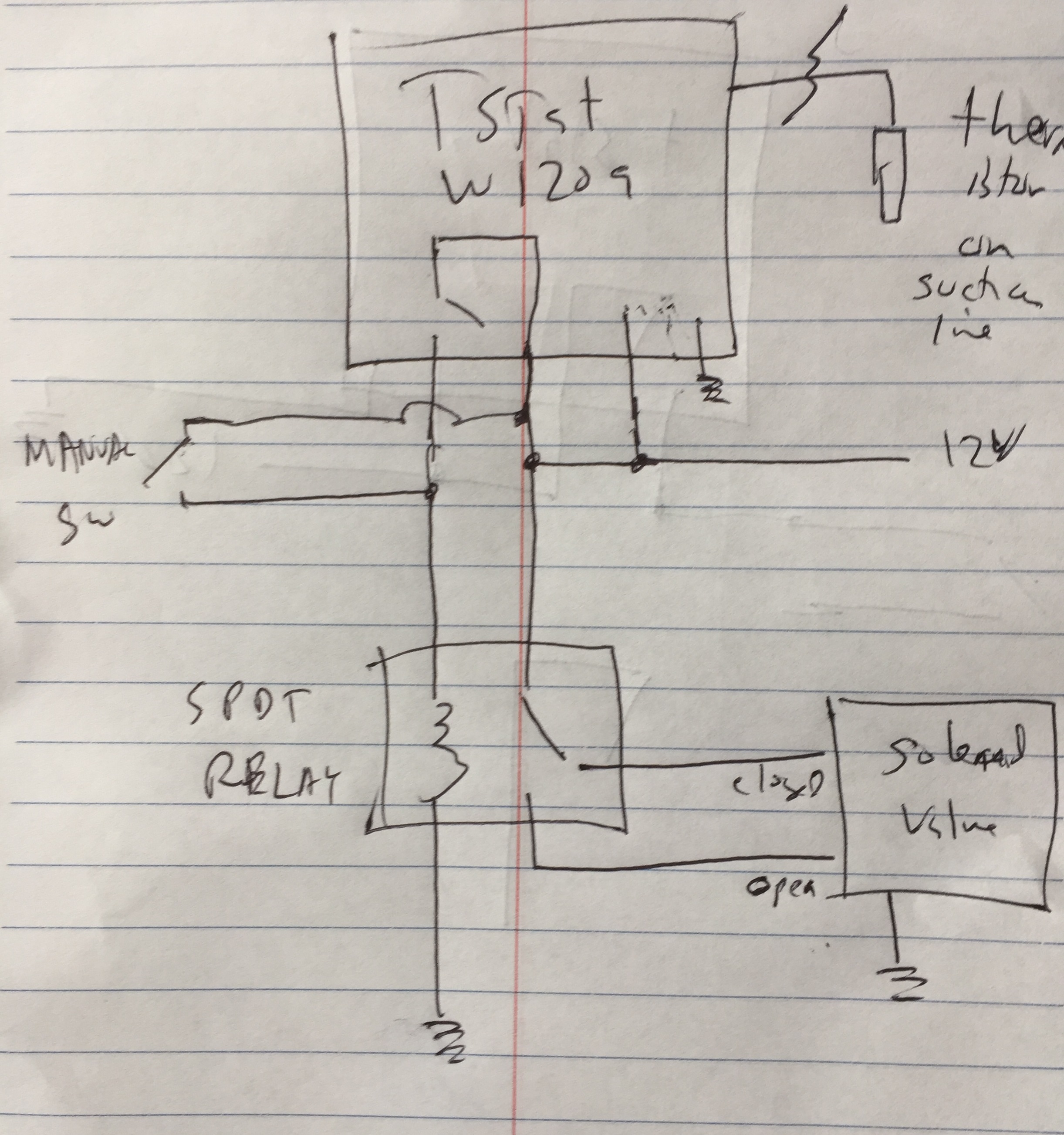

CharlieM, the thermostat I'm planning to use is crazy cheap too.
https://www.amazon.com/LM-YN-Thermostat-Fahrenheit-Temperature/dp/B076Y8RBJ6/ref=asc_df_B076Y8RBJ6/?tag=hyprod-20&linkCode=df0&hvadid=198093463189&hvpos=1o2&hvnetw=g&hvrand=51075119854268219&hvpone=&hvptwo=&hvqmt=&hvdev=c&hvdvcmdl=&hvlocint=&hvlocphy=9009728&hvtargid=pla-578924223832&psc=1
I already used one to have an actual adjustable thermostat on the gas side of the water heater to save wasting water adjusting while taking showers. So far it works well but I don't have much experience yet.
My thought was to just via trial and error (at temps above freezing) to add as many temp sensors and thermostats as needed in as many places as required. They use normally open relays so putting several in parallel is going to trigger the circ pump or solenoid to start whenever the coldest one calls for heat, as well as provide for redundancy.
I too was thinking to add a manual switch to run the circ pump for 30 seconds to avoid water waste showering too. Looks like we both dry camp a lot and are always looking for ways to save water.
Your use of just a solenoid is triggering me to take another look and my heat transfer calculations. The reason I am planning both a circ pump and a solenoid is because while the heat transfer rates between the copper tubes immersed in the two tank drain lines will be pretty good, it will never be as good as just dumping a little hot water directly in the fresh tank is. So in order to not overheat the fresh tank I've been planning separate systems. I'll go through those numbers again and see how bad the imbalance will be.
I really want to try the internal drain line heaters because I've done a few thermosiphon heat transfer systems in the past and they're a lot of fun. They're also very hard to predict via calculation, even fluid dynamicists have trouble with them.  If it works it will eliminate the need for antifreeze in moderate freezing conditions without having to waste huge amounts of energy on electric tank heating pads.
I actually think the pod plumbing and low point drain design lends itself to this type of freeze protection system, we'll see how it turns out and I'll keep you posted.

Sounds like you're on a roll. I'm an engineer and approach such tasks with prelim calcs too. However, with all the variables in your project I'd expect huge uncertainties...like +/- 100% LOL .
A few thoughts: Your thermostat is dirt cheap and it would be a more precise solution than my timer. I didn't find that or it wasn't available when I started my job. I really like the idea of using HW from the heater with the onboard pump and dumping back to the FW tank. Consumes no water, does heat the tank and the manual mode for showers really works even in non freezing weather. For the waste tanks I really think some antifreeze is the easy solution, especially for the few times I camp in sub freezing WX. The black tank should take care of itself with all the microbial action and the gray tank shouldn't take much. For the cost of a few gallons of AF it saves a lot of work. BTW this system also works for nights when the trailer is at home, unwinterized, and temps drop. It means I don't have to winterize/dewinterize during the shoulder seasons. The FW system is the only vulnerability since the waste tanks would be empty and open. A small electric heater keeps the interior above freezing and the circulator takes care of exposed plumbing.
That said, I wonder if you could glue a coil of copper tubing to the bottom of each waste tank near the exit ports. Circulate the HW through them via thermostat. I think the waste tanks are ABS so you could use a conductive epoxy ABS. Cover them with spray foam insulation. No tank penetrations or fittings required and all work can be done on the bottom of the tanks. .  No such solution for the FW tank 'cause it's polyethylene.
Posted By: offgrid
Date Posted: 01 Oct 2018 at 11:58am
Yes, I agree that an overall modelling uncertainty of 100% is in the right range. As you know, lots of engineering has uncertainties like that and the solutions still work out just fine. The main sources of error here are the heat loss rates in the tanks and plumbing, and the heat transfer rates in the heat exchangers.  The heat losses in the tanks and pipes are a matter of surface area and r values, so pretty well understood, so I think those are maybe +-30-50% at worst. Those will govern how much total propane or electric energy is required from the water heater. There is plenty to spare so not a big deal if I get that wrong.
The heat exchange transfer rates are less well understood, those probably are actually about a factor of 2. Those govern how long the circ pump is on. So I plan to design for worst case and if the transfers are more efficient, great. The power requirement for the circ pump is so low that it really doesn't matter much.
Actually it turns out after some more research that ciculators use less power and are more reliable than solenoid valves. The reason looks like it is because the circulators aren't trying to fight against water pressure, they just pump a small amount of water at very low head pressure from the hot to the cold side of the water heater. I would prefer to use a circulator for everything except that I can't figure out how to transfer heat to the fresh water tank that way, without putting more holes in the tank. As you say polyethylene isn't the best material to try to adhere stuff to.
The other reason I like the idea of using a circulator in the rPod 179 is because the hot and cold low point lines are adjacent and at the far ends of the plumbing run so by recirculating between the hot and cold lines you are guaranteed to heat all the pressure lines.
You could adhere copper tubing to the waste tank bottoms but it would require much more tubing than a immersion heat exchanger, and I would be concerned about how to heat the drain lines that way. The drain lines and gate valves are going to be more prone to freezing than the tanks themselves.  I don't plan on inserting anything into the waste tanks themselves, the Cu heat exchange tubing would be inside the drain lines, so no new holes in the tanks. I've done horizontal tube immersion heat exchangers before and as you might expect, copper ones work quite well. I used to heat my hot tub that way from my gas water heater, silent and almost zero electrical requirements.
I did take a look at flow rates though the heat exchangers vs just running hot water into the tank and the duty cycle I get for running hot water into the tank is well under 1%, so it sounds like its about where you set your timer. The duty cycle for the heat exchangers/circulator is between 25 and 50%., so they are not a good match.  So I can't simply dump water from the heat exchangers back into the fresh water tank.
Maybe I should just go ahead and install a couple of blind bulkhead fittings in the fresh water tank install a heat exchanger through it, and dispense with the solenoid valve. I could route one of the lines from that exchanger next to the pressure pump suction line to heat that. Then I could probably just leave the circulator on all the time when its below freezing, that would really simplify things. It would still only use well under 20Ah per day, not a big deal.

1.  this will require a tap into fresh water tank for return correct? what is the best way to do that?
2. concept question: what about the water lines at a sink for instance? no water actually circulates say the last foot unless you open the sink valves.  Does the water actually circulate enough within the line to accomplish the necessary heat distribution ?  or is this moot since these areas are in heated living areas?  for instance in Charlies schematic of the water lines, the hot and cold to the shower?
3. Is the manual valve on the solenoid pump just for pressure and flow limiting ?

Posted By: offgrid
Date Posted: 22 Jan 2019 at 3:35pm
I'm not familiar with the plumbing arrangement on a 182g but if its anything like the 179 FR conveniently runs the hot and cold lines together. My endpoint is at the hot and cold low point drains by the fridge.
I would suggest doing away with all the low point drains and sealing the holes with closed cell foam insulation. If you want to winterize with antifreeze just open the valve at the far end and run the antifreeze through the whole system that way. You'll want cutoff valves for your outside shower too.
The second valve is just an inline valve to cut off pressure from the pump to the cold water line, a tee isn't required. Then the solenoid goes between the cold water line side (not the pump side) of that valve and drains into the fresh water tank. When the thermostat calls for heat the solenoid valve will open and the pump will pump water out of the fresh tank, through the hot water heater and out the hot water line. The hot water will return via the cold water line from the far point, run through the solenoid valve and back down into the fresh tank, thereby completing the loop and warming everything up in the process.  Hope that makes sense.

Posted By: offgrid
Date Posted: 22 Jan 2019 at 6:14pm
Yep, and you raise a good point on the city water. I really never use that so I hadn't considered it. You'll want that disconnected for the recirc system to work correctly. That shouldn't be a problem because that connection would be the first to freeze up in the winter anyway. Just refill your fresh water tank with the city water if you run out.
Posted By: texman
Date Posted: 22 Jan 2019 at 7:02pm
So the solenoid is triggered by thermostat A.  The opening of the solenoid relieves pressure which triggers the pump to come on and cause recirculating water to flow through system.  Thermostat B controls the water heater and triggers the water heater to come on as the recirculating water is cooled by running through the lines and fresh water tank. At this point the water heater is on, the pump is running and the solenoid is open. The water heater will reach the set point temp and turn itself off according to set point of thermostat B. Thermostat A will cause the solenoid to close at the set point.  Thermostat A should be a low temp like 60 deg, for instance. Thermostat B should be normal hot water temp of say 125 deg. The pump will continue to run until pressure is restored to system.  Correct?

Posted By: offgrid
Date Posted: 23 Jan 2019 at 5:10am
Skirting and heating is not a good solution unless you're parking the trailer for a long period. If you're on the road in cold weather or camping for a couple of days between moves its not going to be very practical. The recirc system is going to cost all of about $50 to do at most so its really going to be cost effective if it works well.  But to each their own.
texman, you have the operating theory correct, Just one clarification,  the thermostat on the water heater operates independently of the one on the recirc system. The water heater will turn on when its thermostat calls for heat, which might or might not be when the recirc system is operating.
The purpose for adding the new thermostat on the water heater is only to be able to set the water temp lower than the 130 deg non adjustable setting of the standard thermostat. By setting the temp down around 102-110 degrees (whatever feels comfortable to you) you don't ever get scalded, you don't need to fiddle with adjusting the water temp, and you waste less water. So, you won't need to change the recirc system back to its normal hot and cold setup in order to use the water in the winter.
In my case, when I do the recirc mod I don't think I'll ever change it back to allow separate hot and cold line function, even in summer. As I don't drink or rinse food with the trailer tap water (I don't trust the water in the tank so I use bottled water for those purposes and for brushing my teeth),  I really have no need for the cold water function.
I think you shouldn't need to set the recirc thermostat setpoint anywhere near as high as 60 degrees. If its temp sensor is located at the coldest low point of the system its probably OK to set it more like 35-40 degrees. Some testing will probably be required to dial that in. The temp sensors on the little thermostat boards are thermistors so if the wires to them are too short you can cut them and splice in longer wires without causing a problem.  The boards are supposed to have a temp calibration adjustment but the one I bought didn't, so I had to use a separate thermometer to set up mine the first time. Just immerse both the temp probe and a known good thermometer in a glass of water and record the temp difference for later use.
Re your earlier question about whether the water recirc freeze protection will work for the risers up to the trailer appliances from the water lines in the floor, I would assume that it doesn't until proven otherwise. So, there should be a way for maintaining the interior of the trailer above freezing at all times unless you winterize. I'd also leave the cabinet doors open a bit under the sink and by the new cutoffs you would install for the outside shower.
That being said, since those appliance lines are risers, it is very likely that the water in them will warm somewhat just from natural convection from the heated lines in the floor. You'd have to experiment a bit and maybe take some temp measurements to determine how warm the interior of the trailer needs to be to keep them from freezing. It might be a pretty low temp.

Posted By: offgrid
Date Posted: 28 Apr 2020 at 12:14pm
Sorry I meant this one. Since the pex lines are 1/2 inch I think a ball valve that size should be fine and easiest to connect to.
https://www.amazon.com/dp/B06XD3W8QD/ref=sspa_dk_detail_1?psc=1&pd_rd_i=B06XD3W8QD&pd_rd_w=ZcqXB&pf_rd_p=48d372c1-f7e1-4b8b-9d02-4bd86f5158c5&pd_rd_wg=mM9w4&pf_rd_r=NEEESJ4QP5DX3YFSGKXY&pd_rd_r=d069d658-310a-4980-a490-2ba75ee00402&spLa=ZW5jcnlwdGVkUXVhbGlmaWVyPUExN1FMTVVPVEIzWkxJJmVuY3J5cHRlZElkPUEwMjk2ODE3M0FGQjYzS0szWFpSOSZlbmNyeXB0ZWRBZElkPUEwMTM2MTE2MzRCT1M0RzhPQkY2QiZ3aWRnZXROYW1lPXNwX2RldGFpbCZhY3Rpb249Y2xpY2tSZWRpcmVjdCZkb05vdExvZ0NsaWNrPXRydWU= - https://www.amazon.com/dp/B06XD3W8QD/ref=sspa_dk_detail_1?psc=1&pd_rd_i=B06XD3W8QD&pd_rd_w=ZcqXB&pf_rd_p=48d372c1-f7e1-4b8b-9d02-4bd86f5158c5&pd_rd_wg=mM9w4&pf_rd_r=NEEESJ4QP5DX3YFSGKXY&pd_rd_r=d069d658-310a-4980-a490-2ba75ee00402&spLa=ZW5jcnlwdGVkUXVhbGlmaWVyPUExN1FMTVVPVEIzWkxJJmVuY3J5cHRlZElkPUEwMjk2ODE3M0FGQjYzS0szWFpSOSZlbmNyeXB0ZWRBZElkPUEwMTM2MTE2MzRCT1M0RzhPQkY2QiZ3aWRnZXROYW1lPXNwX2RldGFpbCZhY3Rpb249Y2xpY2tSZWRpcmVjdCZkb05vdExvZ0NsaWNrPXRydWU=
Up to you but I wouldn't want to  get up all night long to turn the valve on and off manually. And running it continuously would waste a ton of propane and electricity.
Here's a rough schematic of what I had in mind to do. The manual switch and tstat spst relay contacts are in parallel so either will turn on the spdt relay coil, the contacts of which then send 12V to the "open" wire of the valve. A spdt relay is needed because you have to power on the valve both open and closed. Once its in a position it stays there and doesn't draw any power, so you can leave 12V on the "closed" wire of the valve when the manual switch and the tstat are off. Hope that makes sense.

Posted By: offgrid
Date Posted: 28 Apr 2020 at 2:49pm
The W1209 thermostats only cost a few $.  They're really pretty nice, versatile, easy to set up and have a nice little display. You can calibrate the temp probe in an ice bath and adjust for any errors using a setpoint. You can power everything up using the 12V switched supply at the water heater. The probe should be long enough to reach from there to the base of the pump supply line which is going to be place that will freeze first.  You can put your manual switch on the wall next to the outlet by the furnace if you don't want to fish another set of wires all the way back to where the other switches are.
Or, get one of these instead of a manual on/off switch. Just push the button once and forget. Not sure if 10 seconds is enough or not, might need a different potentiometer.
https://www.amazon.com/Akozon-Module-Adjustable-Timing-1-10sec/dp/B07H7J91RM/ref=sr_1_20?dchild=1&keywords=12v+time+delay+switch&qid=1588102892&sr=8-20 - https://www.amazon.com/Akozon-Module-Adjustable-Timing-1-10sec/dp/B07H7J91RM/ref=sr_1_20?dchild=1&keywords=12v+time+delay+switch&qid=1588102892&sr=8-20
