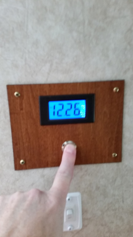

back before you could buy a kit, I built and installed this for about $4..
https://postimg.cc/image/txzj01x3x/">
https://postimg.cc/image/io27rd2ot/">
