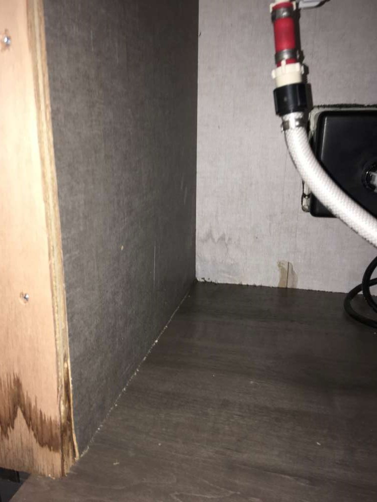

Water is getting inside the wall of our 2018 RP180 slide-out. With the trailer stored, slide-out retracted, trailer jacked slightly high in the front, water is working its way down to the left side bottom track of the slide-out and dripping onto the floor. We find water on the floor just under the left front corner of the cabinet under the sink after a rain. It drips out where the aluminum slide-out track ends.
At first, I thought it was getting into the wall by leaking around the outside shower receptacle, so I caulked around that. No fix. Next, I thought it was the window leaking, so I used black electrical tape to temporarily seal the window frame to the outside wall across the top and down the sides. No fix.
I've opened and checked the top of the slide-out and it's dry, and all the caulked areas up top seem fine.
Any suggestions?
First photo is taken inside the cabinet under the sink in the slide-out. You can see water damage where it has wicked up into the panels. But there's no water along the cabinet bottom, it's below that apparently.
Second photo shows the left side bottom of the retracted slide-out. The yellow circle is where the water drips out.

I've opened the slide-out and checked the seals. The seals are in perfect condition and pliable, and there was no dirt or debris.. There was no water at all on the top or sides of the slide-out.
The water is getting inside the wall, not past one of the large seals.. I guess the refrigerator upper and lower vents are the next thing to check.
