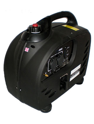

Mike,
Here's the one I bought, DG- 3000 inverter, Pure sine wave. $479 with free shipping. Worked the a/c and microwave fine and was really quiet. Ran a test with the A/C and Microwave, started the A/C first, then the microwave and the A/C didn't flutter. Bought it mostly for a hair dryer and the occasional battery bump, when charging the battery it just idles and is very quite, and even with the a/c running it wasn't really that loud, went full throttle on A/C startup then About half throttle to keep it running. Was quieter than other peoples RV gennys at Joshua Tree. I do plan to build a Generator Baffle box though, Because, that's what we do, modify everything! After looking at equivalent honda's and yamaha's for 5 times the money I figured why not try this, As This is a rarely used item for me, Just for cooling down the Rpod occasionally, the charging thing, and that dam hair dryer. Glad I did! |
