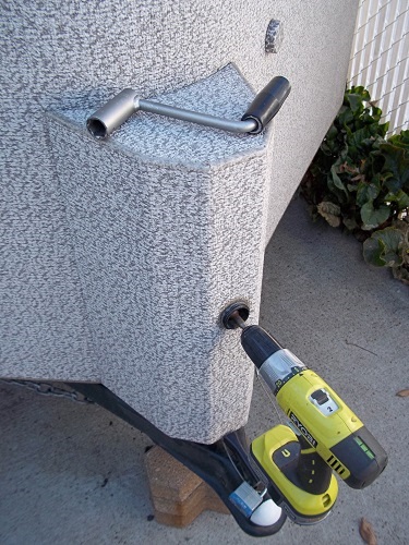

I took the crank off the OEM jack, put the right size nut on the shaft (same as the stabilizers, for which I use the drill also) and, similar to Marwayne, use a drill to crank the jack up and down.  Assuming you have the drill, it takes about $4 worth of parts and it works great, even cranking the jack way up to put sway bars on.  I've been doing this, and nothing else, for at least a couple of years.  The drill comes in handy occasionally for other things too. This is so simple, effective and easy it's really amazing to me that anyone bothers with any other method.  I have replaced a jack on a trailer before (not the pod).  It's at least as easy to convert the existing jack to drill-operated as it is to put on another jack, and there is no wiring to mess with or worry about.  If something were to ever happen to my drill or it just ran out of juice, I can always crank the jack with the same socket on a ratchet or with a lug wrench.

I carry a drill for the stabilizers. I did get an electric jack. The drill/driver came in handy for some repairs made necessary by the mishap we had recently. Embarrassed I still have the old manual jack. I will try to convert it so it will be available as a backup in case the electric jack fails.
I did hand-crank the stabilizers on our first big trip. That got old fast. We got the drill/driver after that first trip.
