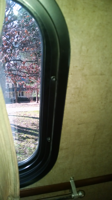

Screws are on the inside, not around the ouside of the frame, but on the recessed part of the frame. Think of the frame as a two-part channel being clamped around the wall. A cross section would look like a C with the wall being in the inside part of the C and the window being like this ----C.
Here's a picture that might help:
This is a picture of the kitchen window in our RP-179, which also does not open. Pardon me as I assumed it was a window in the wall, not in the rear. That modifies my suggestion to agree with checking the factory caulking. I ended up removing the factory silicone sealant and applying new sealant along the top and two sides of our kitchen window after seeing gaps in the factory sealant. I also had to tighten the screws as the ones along the top and right side were loose. What complicates this is that a flat window is installed in a curved surface. It would have been better for Forest River to have put a flat frame in which the window could sit, but that might have had its own complications.
The part about ensuring the weep holes are clear is still valid. Also, make sure the weep holes are on the bottom. I don't think it is unprecedented for the window to have been installed upside-down.
