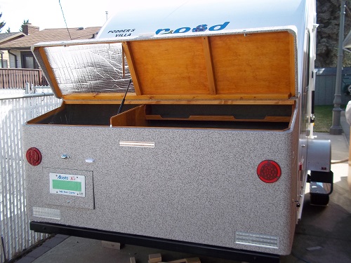

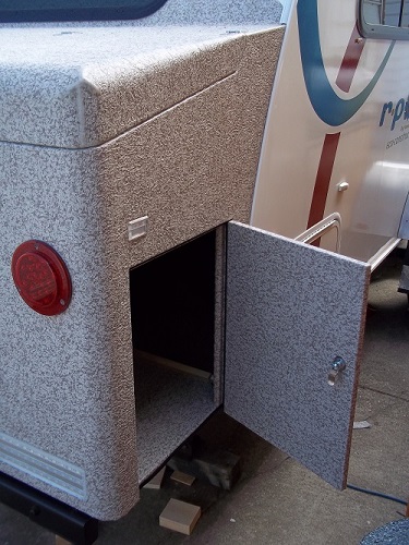

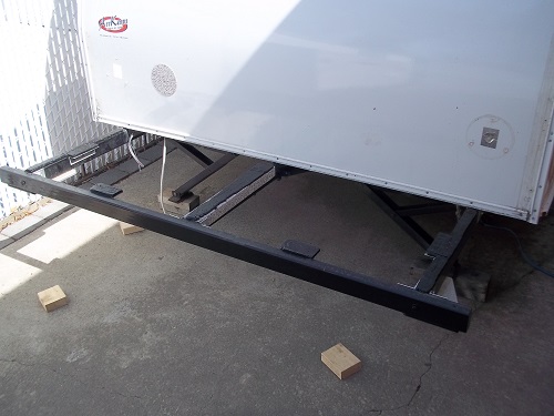

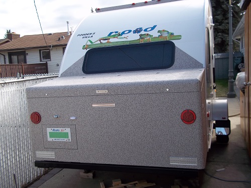

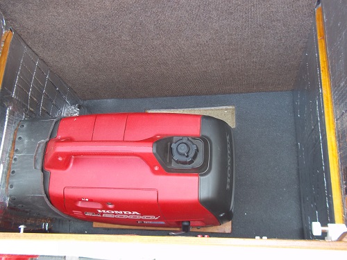

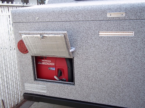

My hats off to you. That is impressive. Geezer, I wish I lived closer to you because I'd hire you to build me that cool rig setup.
Congrats, I'm jealous.
