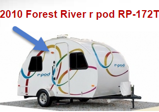

Hi there,
quick question (and hopefully an easy one!)  our exterior door light on our Rpod 172T has burned out.  We bought this camper second hand a few years back and it has been wonderful, but it did not come with the service manual.
Just curious if anyone knows the proper procedure to replace this bulb?  I think this light is also on newer modules, so I'm hoping someone may have had this experience.
Thanks in advance!

On our 2009 173 pod there is an amber lens on this light that is a tight friction fit. GENTLY pry the lens off from the bottom with a flat blade screw driver. it should be easy to match the 12 volt bulb at an auto supply store.
Hope this helps

Vann,
Thanks so much!  that's exactly what it is!
