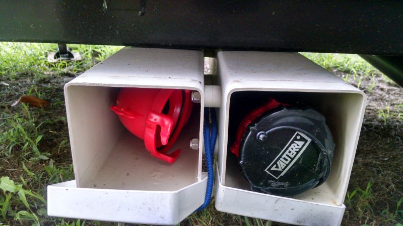

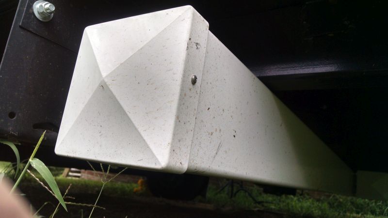

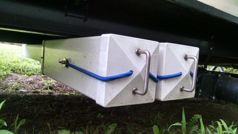

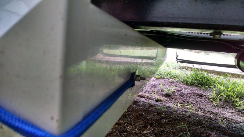

I did this mod, and it turned out very well.  I found that the front-to-back box beams that form the structure of the R-pod) are very hard steel.  I broke at least two drill bits, though that could have been from not drilling straight as I laid under the frame.  I used stainless steel hardware throughout.  To mount the tubes into the frame, I drilled larger holes in the bottom and screwed upward with a long screwdriver, retaining the tube with screws and washers.  A couple of pictures attached; please let me know if you need more information.

Sorry for the delay in replying.  Yes, you have that right, but my sequence needs a little explaining.  I knew I couldn't lie under Our-Pod and blindly drill and screw upwards.  So, I first measured the side-to-side dimension of the beam centerlines, marked it on the plastic tube, drilled the larger holes, then use that as the template to drill the smaller holes.  THEN, I laid in the mud and drilled/ screwed!  When I get a moment, I'll take a picture of the holes.
I like the "Happy Tripping" process of marking, punching, pre-drilling and final drilling.
For "Happy Tripping," the size of the square tube fits the sewer piping rather nicely.  Also, a square tube is easier to work with in this process than a round, constantly moving tube.  And sincerely, the square tubes appeal to my aesthetic sense, i.e., I like them!

One last note:  I bought an 8 foot fence post cover, but the sewer pipe only needs 6.5 ft or so.  As you can see form the photos above, I used the other 1.5 feet for a fittings storage area.  Lock nuts and plastic spacers were found at the local handyman big box store.  Four fence post caps provide the closure at each end of the tubes.
