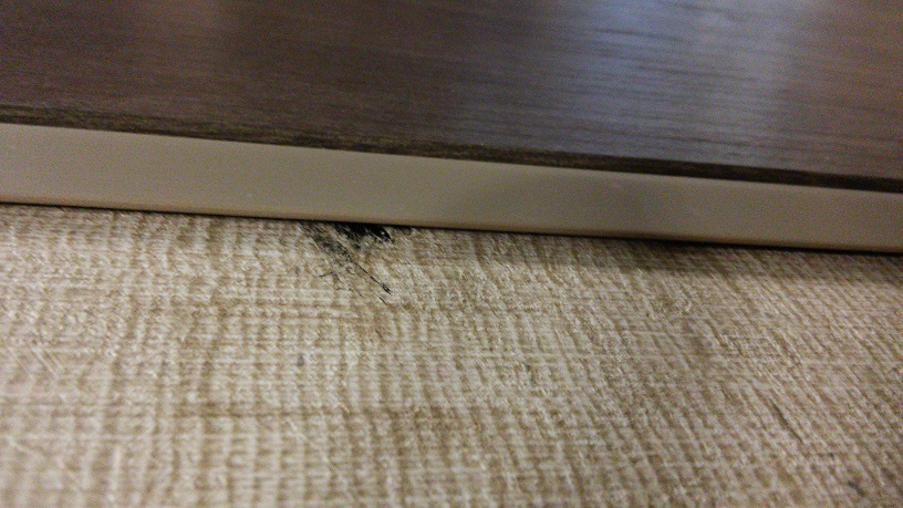

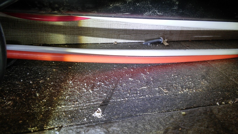

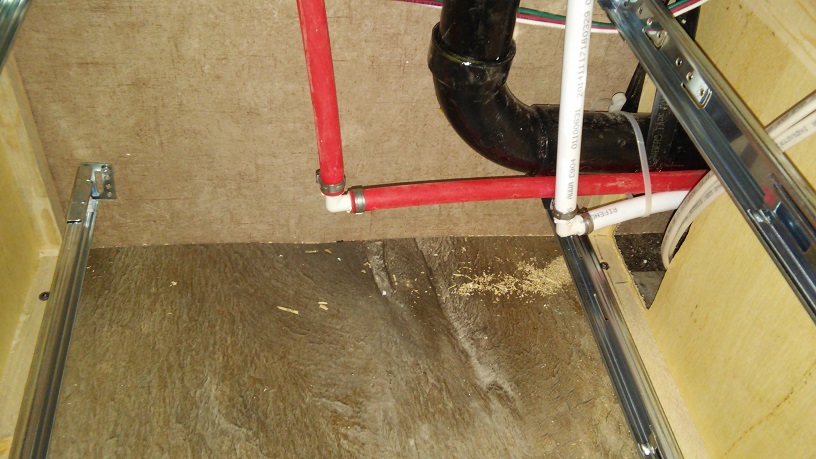

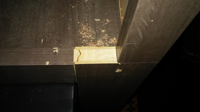

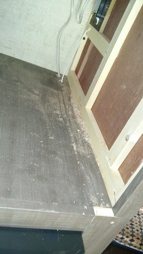

One of the first things I noticed was every time I pulled the trailer I would see saw dust on the floor, the reason for this became clear as I began to make some modifications. Each time I removed a drawer or panel I found the hidden areas filled with saw dust and dropped screws and small trash.

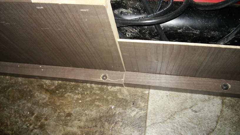

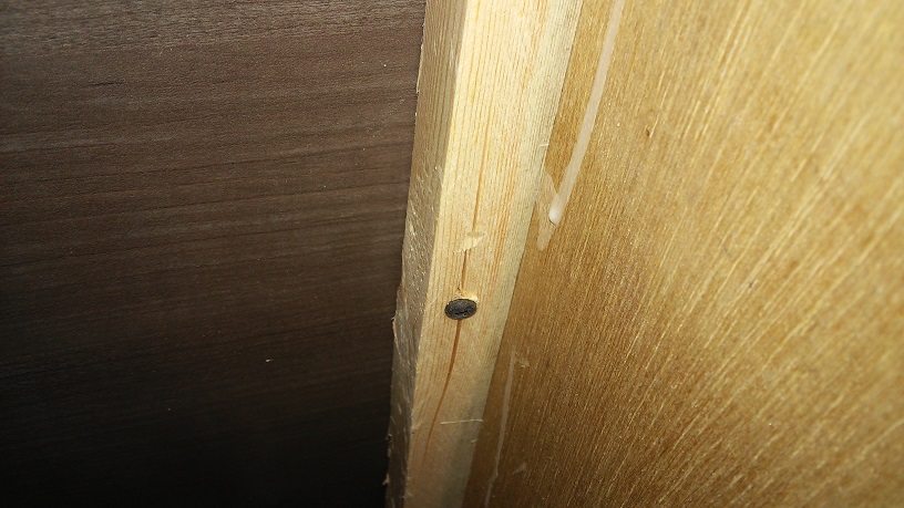

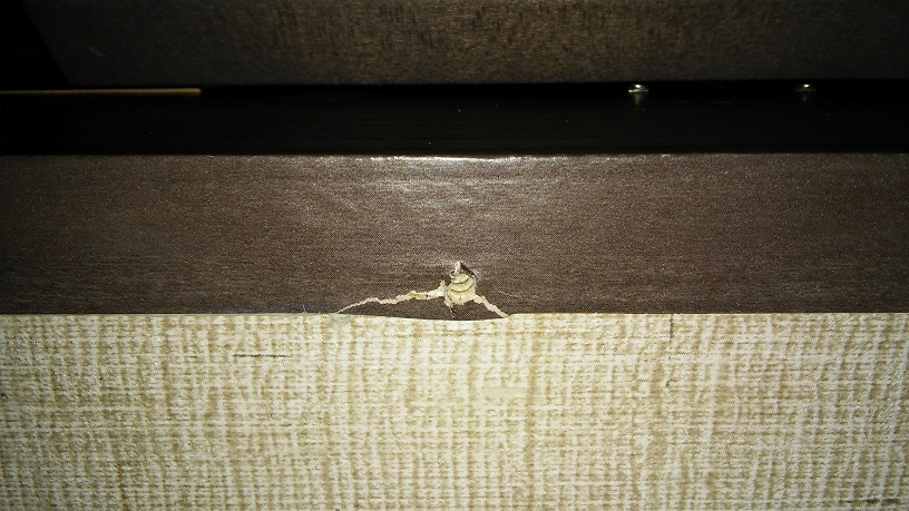

Another build issue is just about every screw you look at inside the camper is over driven, often cracking the wood framing:
The framing under the microwave was cracked

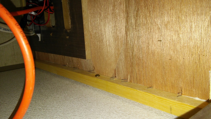

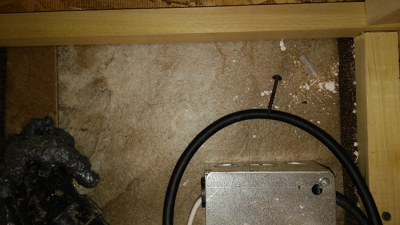

I found stapling that often missed the framing:

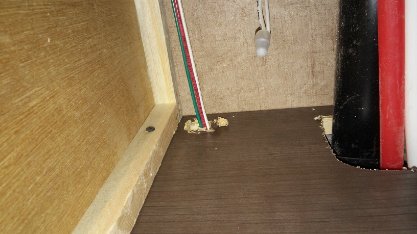

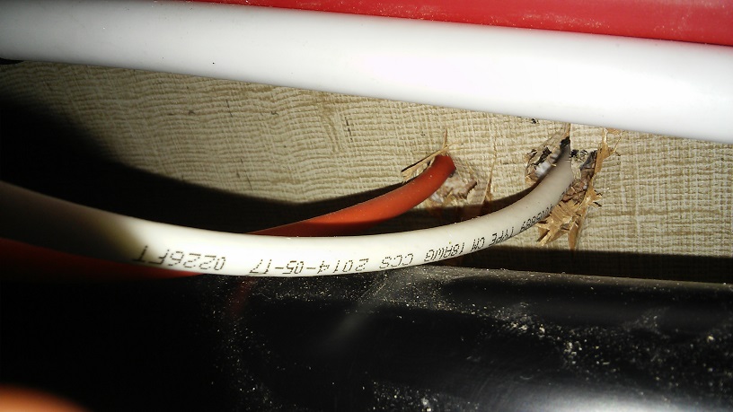

I found holes drilled like this-

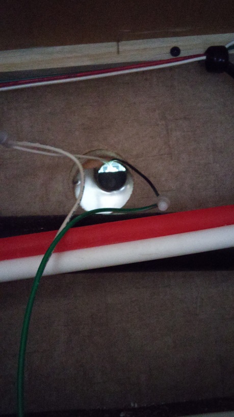

The installation of the outside tag light left a space in the kitchen cabinet open to day light

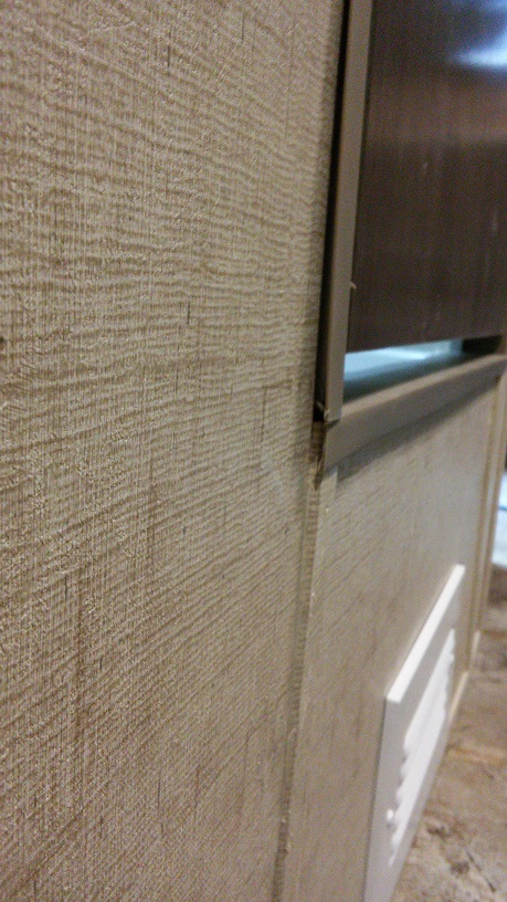

The bathroom door frame is not flush on its corner, and had an area of sloppy glue work:

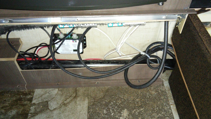

The wiring under the fridge gets pinned on the face of the panel it is supposed to go behind (this had separated the panel from some of its staples) leaving these hoses visible/exposed:

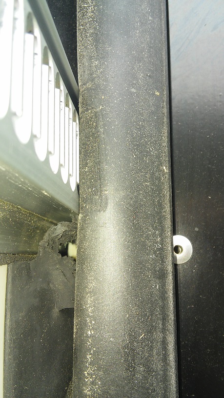

After a few days at home I noticed some torn rubber on the floor, I then found this torn area in the gasket/seal on the slide out

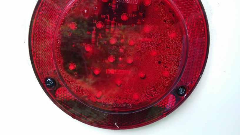

This is what my right tail light looked like after I drove home from the dealer thru some rain. (Actually it was 3/4 filled with water until I drilled a small hole to drain it. & I am happy to report none of the other exterior lights has leaked and this one still works and did not leak once I added some caulk)

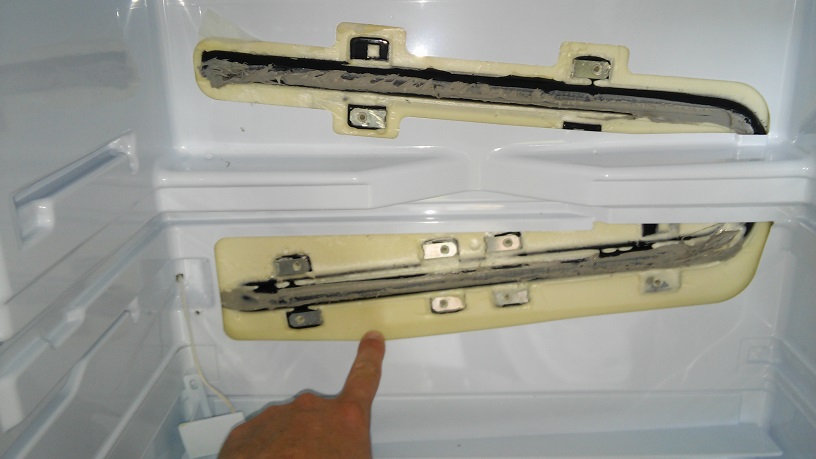

One of the more serious defects in my r-pod was the fridge. After a few days of use in a humid environment it would become filled with condensation, which would cause the open door sensor to start beeping (which is exactly what it should do even if the door is closed because the fridge is not sealed!). After looking on line I saw this was happening to a lot of people. The only the "fixes" I read were to stop that sensor from working properly -to stop its beeping. Those who took the time to force FR or their dealer to replace these fridges were seeing the new fridges reproduce the issue. This indicated that FR's supplier was delivering fridges that were not sealed. So I took off the heat sinks in my fridge and discovered large gaps between the fridges plastic liner and the insulation behind it at these openings. I sealed those interfaces with SI caulk and also caulked the exit holes for 2 wires that were not sealed. I also put some ear plugs in the four screw holes just inside the door. Since then my fridge has run for 2 months without issue. I'm not certain where it was leaking from (behind the heat sinks, the wire exit holes or the screw openings or all those locations). But it is clear my fridge was not sealed and now it is. Here is a look  behind the lower heat sinks showing the gap between the plastic fridge liner and the fridges insulation. This is before I sealed that interface with Si caulk; the photo also shows one of the unsealed wire holes.

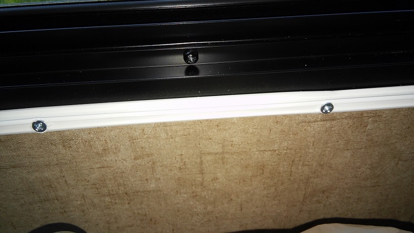

The screws used on the kitchen curtain track block its movements

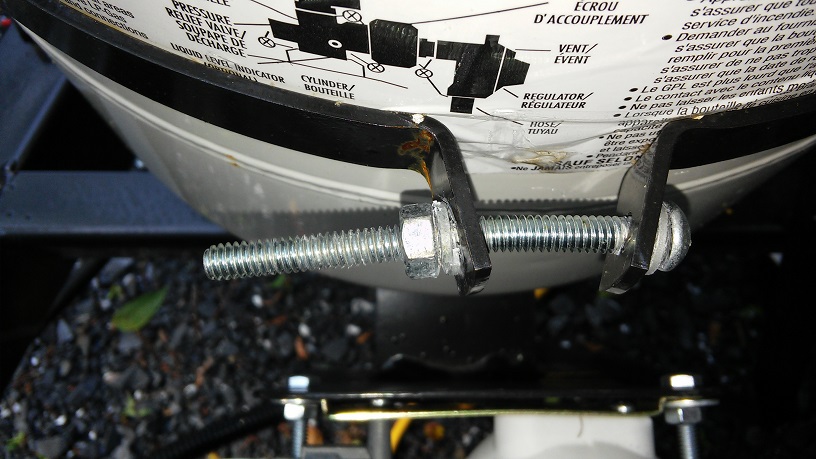

The bolt on my propane tank clamp was bent

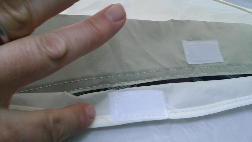

Some velcro tabs on the r-dome were just placed wrong

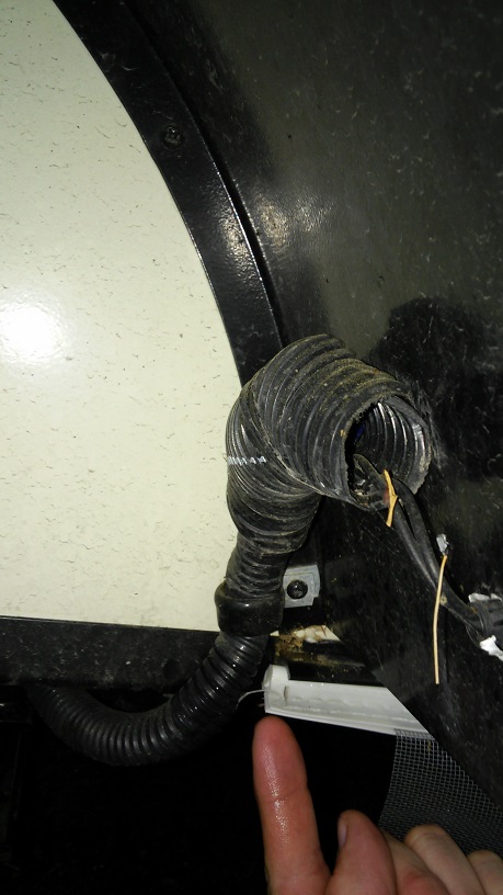

The lower track for the r-dome skirt does not allow the skirt peice of the dome slide to behind the wheel due to the location of these wires.  (Without the skirt I found the r-dome mostly just collects bugs on the inside.)

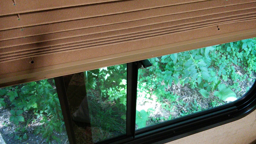

The window locks cannot close when the window is open (they hit the glass) and when the locks are open they get in the way of the blinds-

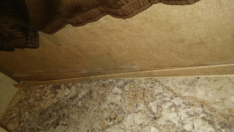

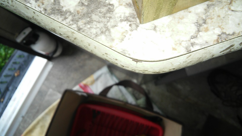

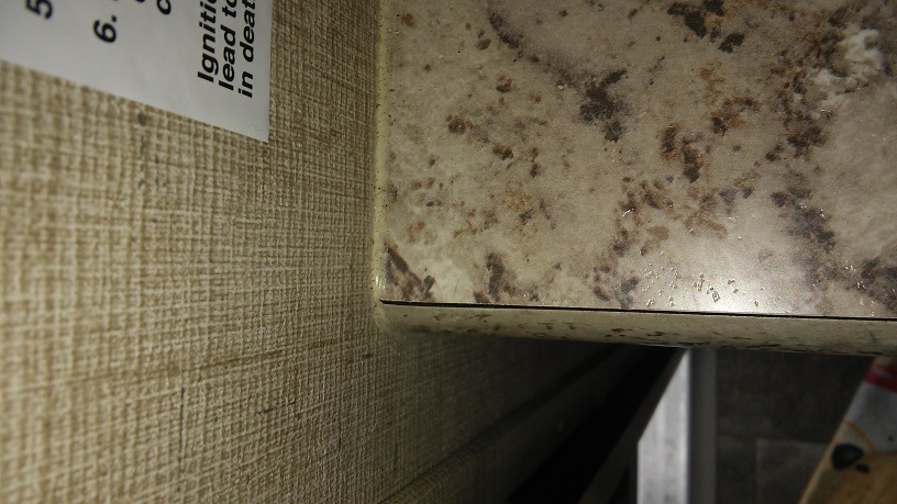

The other issues are cosmetic. The edging of the kitchen counter top has begun to slightly separate /come unglued near the stove top. The same thing is happening to a panel seem behind the stove. This failure of glue surfaces may be associated with the heat generated by the stove as we sometimes made pancakes and coffee on our trip:

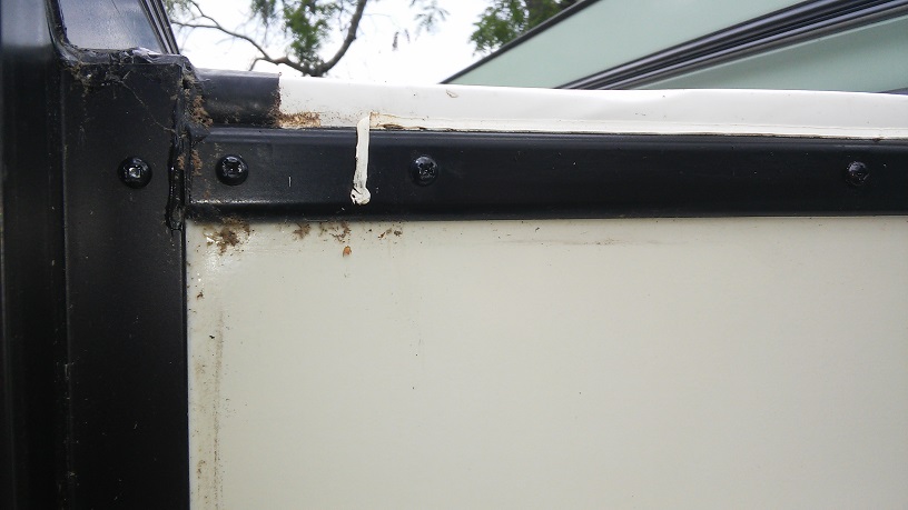

After a month on the road I noticed this caulk start to fall off the top of a slide out seam:

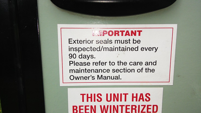

One final complaint is this sticker on my r-pod which in the excitement of buying I failed to really ponder:
This could be translated to "Your brand new $13K camper is guaranteed not to leak for 3 months."

I agree with you 100% on the items your listed and pictured, the frig will be taken apart tomorrow and caulked along with the fan switch, per your notes.  I'm an old construction engineer and also fix things myself as the dealer techs don't know much more about a particular model than we do.  We just got back from a 26 day trip from south Texas to the Apostle Islands on lake superior and all worked well on the R-179 with only a few minor repairs needed.  Also the outside shower box installed over the electrical service plug really bothers me as a design engineer, I had to put a plastic baggie & rubber band on it, just because.
I only got fed up with the frig alarm and after following everyone's advice/repairs on this site I finally resorted to taking the control panel apart, removing the circuit board and drilling a hole in the alarm's diaphragm, peace at last, peace at last, I don't care about any consequences from my actions, good Lord we have peace at last.  My wife said if that frig beeps one more time I'm going back to ice chests like the old pop up camper days. Thanks for all your efforts in making a great post for others to see and learn from.

One thing you can't blame Forest River for is the non-lining up of the velcro stips on the Rdome.  FR doesn't make it, it's made in China by Dometic.
