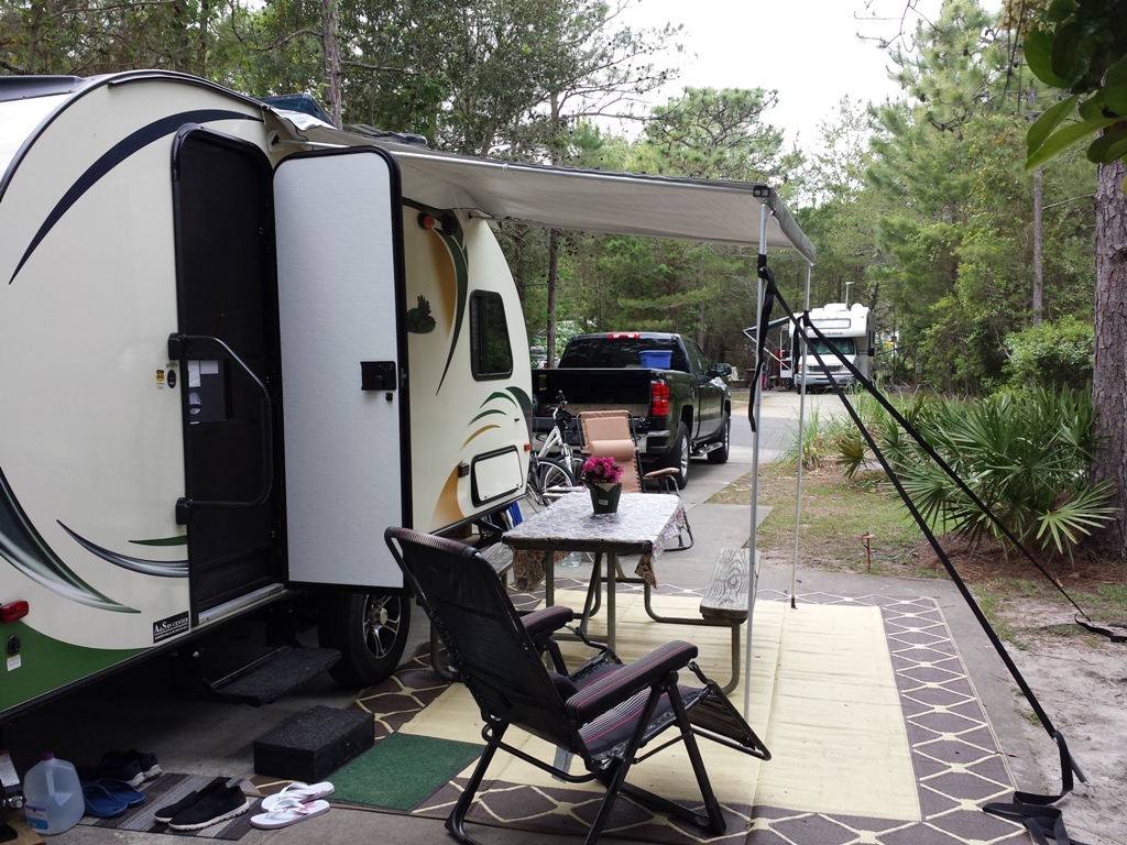

I installed an 8' bag awning (pop-up) on our 179 before I sold it. Use it on one trip, worked great. No problem with the curviture of the r-pod. The R-pod channel was too big so I bought plastic tubing and attached it to the awning, snug fit. Dometic RV Camper Trailer Pop up
8ft A&E Trim Line Bamboo Case Bag Awning Canopy
