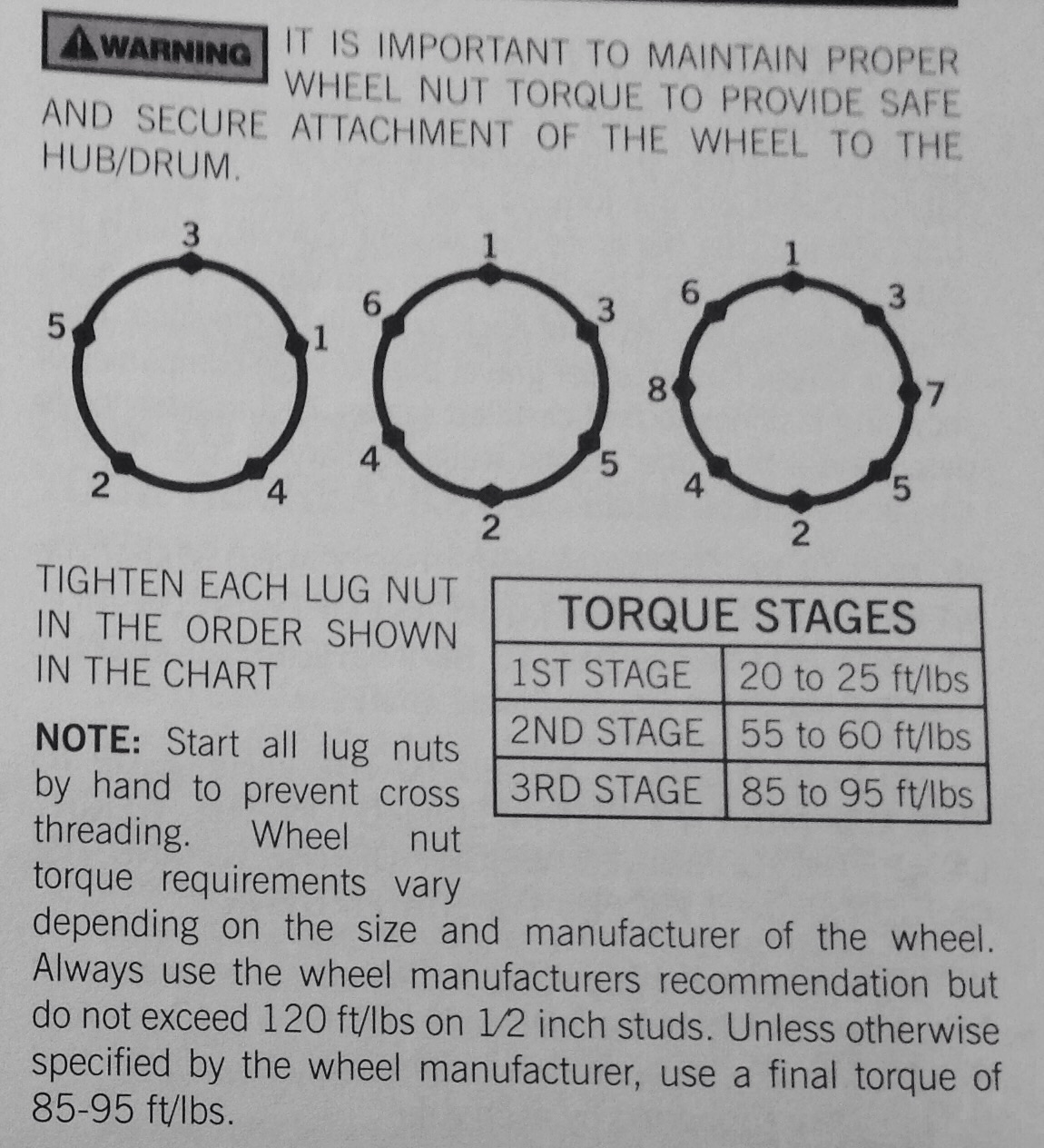

Here's the torque specs from my owners manual, does anyone know what size wrench is used for lug nuts?

Mine takes a 3/4" socket. You'll need to get a deep socket or extend it to get out far enough for the wrench handle.

Direct Link To This Post Posted: 31 May 2015 at 10:31am
Terrific, I'll go get one and take a look. Thanks very much.
