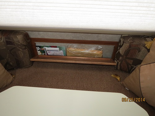

There were three more cabinets to come, one over the microwave and the others on either side of the dinette above the valances.

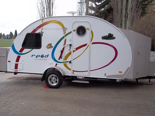

When spring of 2012 came, Sonny went to work on my outside. He put in four windows (portholes): one in the door, one in the bathroom and one over each bunk. Then he removed the AC (what a load off my roof!) and installed a skylight instead. Wow what a difference: I became very bright and cheerful. He then added a storage box on the back for more stuff including a 2000 watt Honda gen. Up front he build a box for batteries, LP bottle, toolbox, etc.

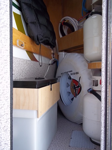

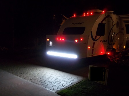

This spring he decided to change my front. The base was there, all we needed was a floor and to close it in, so he did that and now there is room for 2 LP tanks, 2 batteries, toolbox, spare tire, hoses, electrical cords, sewer hose, even a closet rod and other odds and ends. The other thing he did add 8' of LED strip light on the door side to light up the r-dome. We also needed a backup light, so Sonny built and installed it. The first time he turned it on I felt like Han Solo's Millennium Falcon taking off.

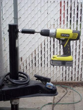

Other things Sonny did include changing the crank tongue jack to electric for cheap, and building a 12 volt electric trailer dolly to manoeuvre me into my tight parking space behind the garage. Being at home saves 80$ a month on storage fees.
