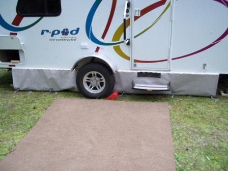

Does anyone know if they make a skirt (don't know what you call it) for the lower part of the trailer? I have the R Dome but it seems there is a track to put a skirt. The dome is great, but it seems if there s a track there should be a skirt for it or if anyone has made such a thing I would love to know.

Yes there is a skirt, it should have bin in the bag with the dome. But it is only a bugscreen, I wanted something solid to keep the wind out.

Direct Link To This Post Posted: 10 Oct 2014 at 10:36am
I like that.  Did you make it yourself?  And what material is it made of?
Direct Link To This Post Posted: 11 Oct 2014 at 10:02am
Yes I made it myself, the material is patio decking. However if I had to do it over again I would use the PVC material that is at the bottom of the r-dome.

Direct Link To This Post Posted: 17 Dec 2014 at 11:21am
We are in process of making our own also.  How is your skirting attached?  We are thinking about either taking the beading off the netting and glueing it on to canvas so it would slide right into the track...or...attaching the skirting to the track with some good glue & velcro.
