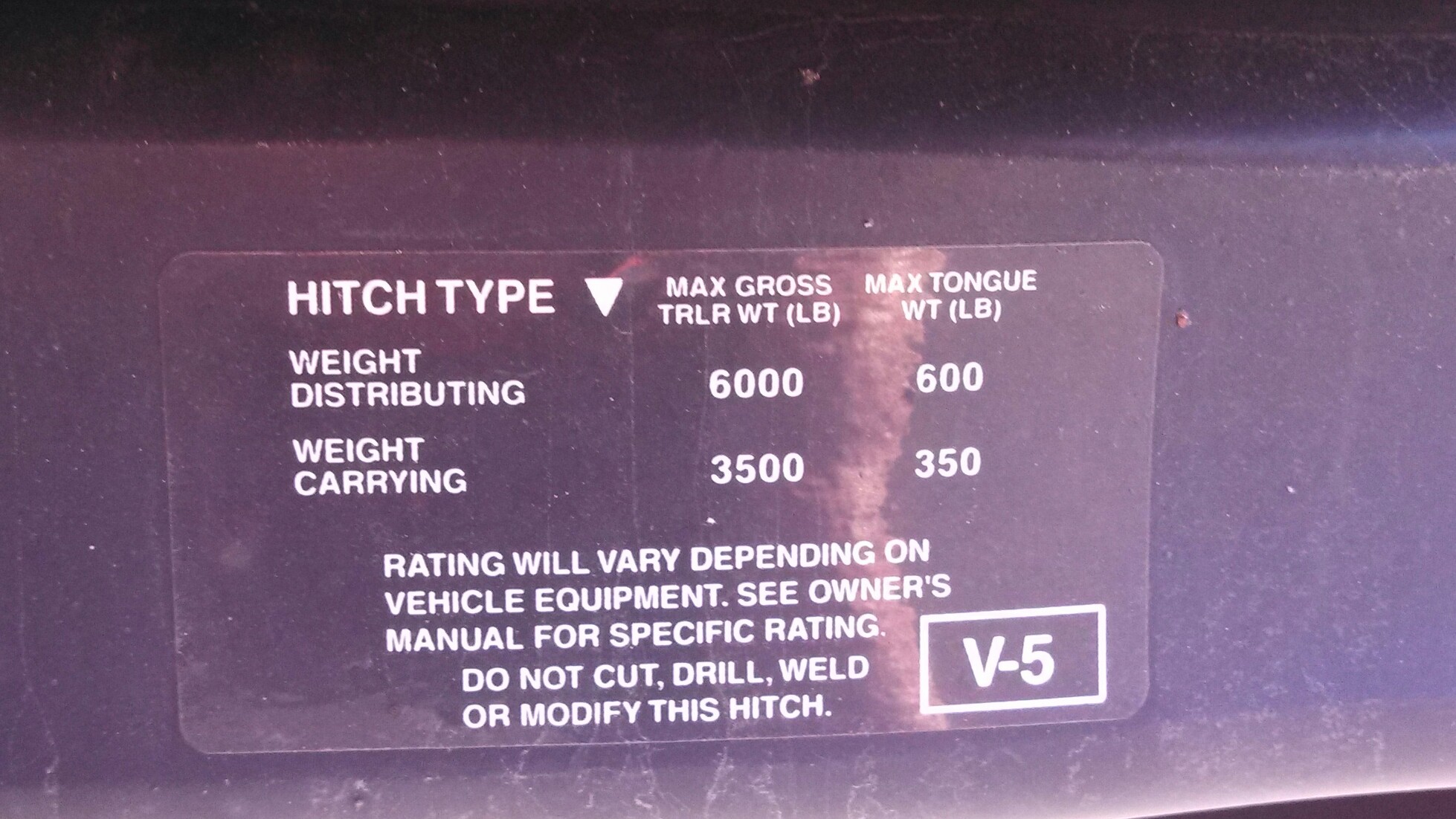

here is the tag on my hitch

     The r-pods will slow you down you will know its back there, I agree your truck will tow the r-pods just a little on the slow side. Trucks are made for working so durability should not be a problem.
