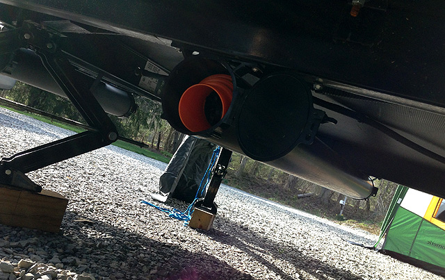

Both of the above are excellent solutions. For me, having the exact size made to order allowed for a 10 minute installation with 4 self tapping hex head ss screws. A little more money, but easy install.
Pic is tube w/RhinoFLEX hose and fittings inside. Edited to remove Ham pic (quoted in next post). It looked a little too much like Spam, but tasted great! -fred

Just to add to the D&W SuperTube...
http://www.dwincorp.com/products/82/SUPER-TUBE I just mounted a D&W SuperTube to the bottom of my 178. I ordered a 61 1/2" tube for the 15' RhinoFLEX Hose. Spec'd 61 1/2" in the order notes. Ordered it on 4/15. Total cost was $77.34 w/shipping and it fits perfectly with all attachments. I used some stainless self-tappers for the mount. Now I have the perfect PooPath! FYI, the note I put in the order form: Please Note: I am ordering a 61 1/2" Super Tube for my rPod 178. 61 1/2" Super Tube. Thank You! |
