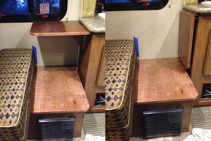

Cold, snowy and icy. Good day to turn on the pod heater and work on a mod!
![]() Counter extension and end table for planned daybed mod. Cushions are reference for daybed mattress thickness. The counter side requires a bit of beefing up so it doesn't flex with hinged extension bracket/corbel. Extension top and table are 1/2" birch ply w/1/4" birch ply edges on bottom and edge banded. Corbel and hinge plate are oak. Fun! ![]() |
