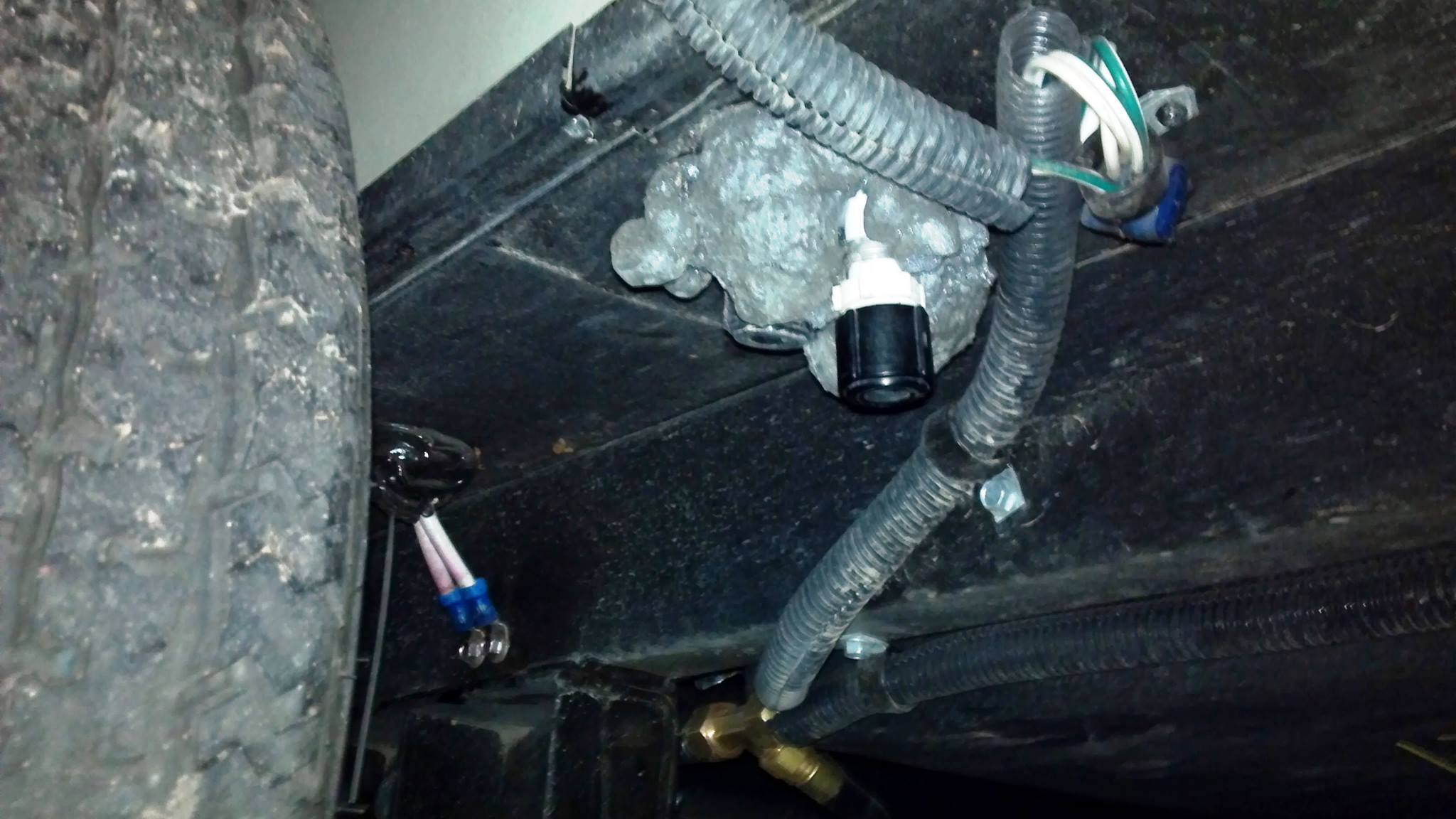

Make sure it's not covered in expanding foam and you just aren't seeing it. |

There will be three. 1 on the FW holding tank, and 2 for the water lines, 1 hot, 1 cold. Those lines will be below the slide, behind the wheel. They may, or may not, be covered in foam before you use them.

Yes, they all have 3 drains. If you used anti freeze, then the low points for the hot/cold lines *may* be okay, due to dilution.. but I would go out and find them and open them. make sure pink stuff drains out. In fact, I would just open them and let as much drain out as wants to. Then call it good.

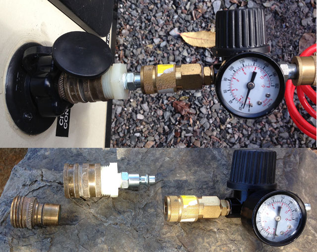

I know it's been discussed many times, but wouldn't draining the system and blowing low pressure air through the system via city water inlet be sufficient in all but the coldest of climes? Oh, and adding a little pink stuff to the sink and shower traps. I don't see any problem with leaving some small amount of liquid in any of the tanks. There is plenty of room for expansion. Of course, this assumes you have access to compressor and can regulate the pressure. I cobbled together a hookup w/regulator which allows me to evacuate the fresh water lines w/20 psi. Is it still necessary to pump pink stuff through the lines? Need schematic of system. I am sure Pink stuff would be a lot easier if you don't have access to air blowout stuff. I know my hodge podge of hardware below is overkill, but I just happened to have the parts sitting around. I blow @ 20 psi until nothing but air out of faucets and toilet. EDIT: After writing the above, I came across this link which indicates that I should either run the pump dry or (easier) pump a little pink stuff through the pump: http://www.rvupgradestore.com/Articles.asp?ID=252 |
