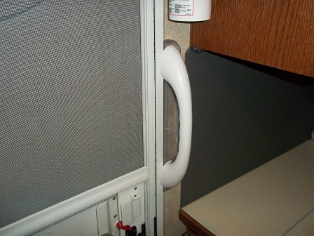

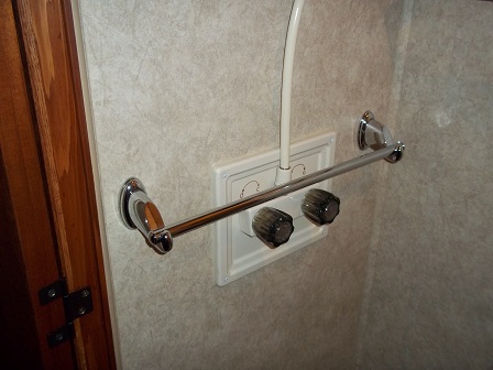

I put a grab bar inside beside the door and a short towel bar in the bathroom to hang on to.

where did you get that removable towel rod? That looks perfect.
