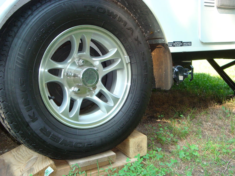

Have any of you installed mud flaps on the rPod's fenders? We took ours out under sloppy conditions (the only kind we had until a week ago), and the rear of the rPod got slimed by road mud off the tires.
I picked up a generic pair at Fleetfarm; but I haven't installed them, because they are too short below the standard fender cutout.

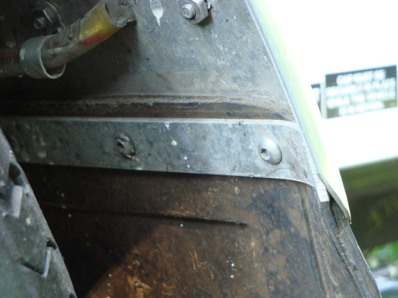

I bought a truck/trailer rubber mud flap and cut it to size much like rpodcamper. I used a smaller stainless steel flathead bolt with stainless steel acorn nuts to hold them on and also used a 1 inch wide aluminum bar on the inside to hold the mud flap in place instead of washers.

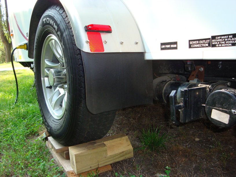

I managed to make at least a 3-hour job out of it in muggy 87-degree heat; but I got the mud flaps installed this past weekend. They look like they belong on it, and I hope they'll provide some serious protection from road slop.
