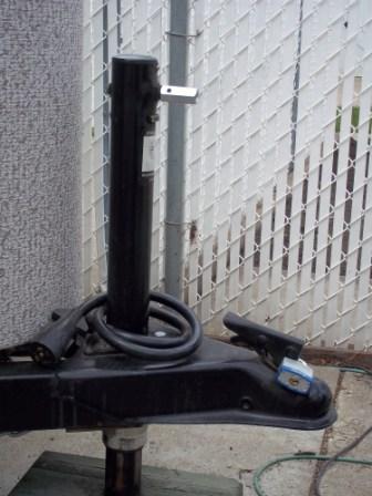

I was going to do something like this but I was not sure if my 19 volt drill would drive it.
Posts: 1004
Direct Link To This Post Posted: 15 May 2013 at 4:55pm
Tongue jack from manual to electric for a few bucks.
Cut of the crank cut a thread on the leftover pin put on a long nut with a set screw done.
A friend welded a socket on the crank, so I can also use it manualy.
