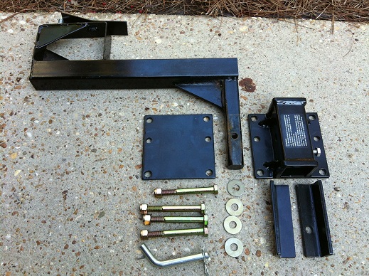

The job begins with a Swagman model 64025 RV Bumper Adapter,
available from Amazon:
http://www.amazon.com/Swagman-RV-2-Bumper-Adaptor/dp/B00174ZHGU/ref=sr_1_5?ie=UTF8&qid=1352492512&sr=8-5&keywords=swagman

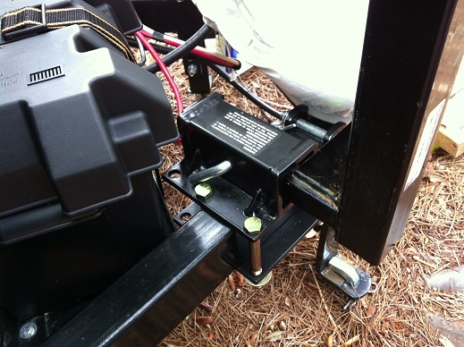

This adapter is designed for a 4” square bumper so some work
is required to mount it on the 2”x3” RPOD frame tubing. The attachment bolts
are replaced with ½ x 4 ½ inch class 8 high strength bolts, flat washers, and
locking nuts to accommodate the 3” frame depth. Two new 9/16” holes, spaced 3”
center-to-center from two of the existing holes, are drilled in the top and
bottom plates to accommodate the 2” frame width. I would have preferred
stainless, but stainless is not as strong as the class 8 bolts so I went with
SAE ½ inch bolts and locking nuts. I did replace the 10 mm hex set screw bolt
with stainless, but be warned, it is metric. The starting kit is shown below:

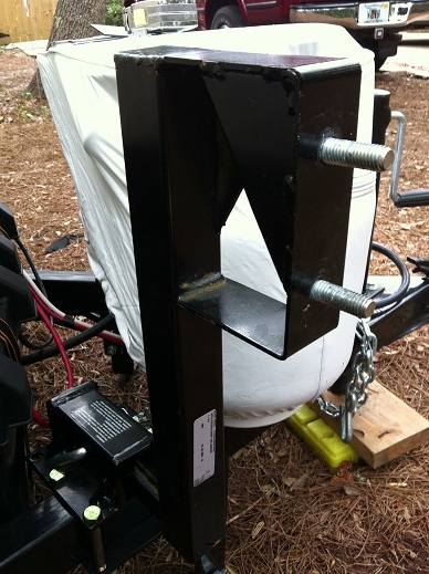

The Swagman adapter provides a 2 inch receiver and the FR
supplied tire carrier requires a 1.25 inch receiver. I used the reducer sleeve
that came with the bike carrier, but similar devices are available elsewhere.

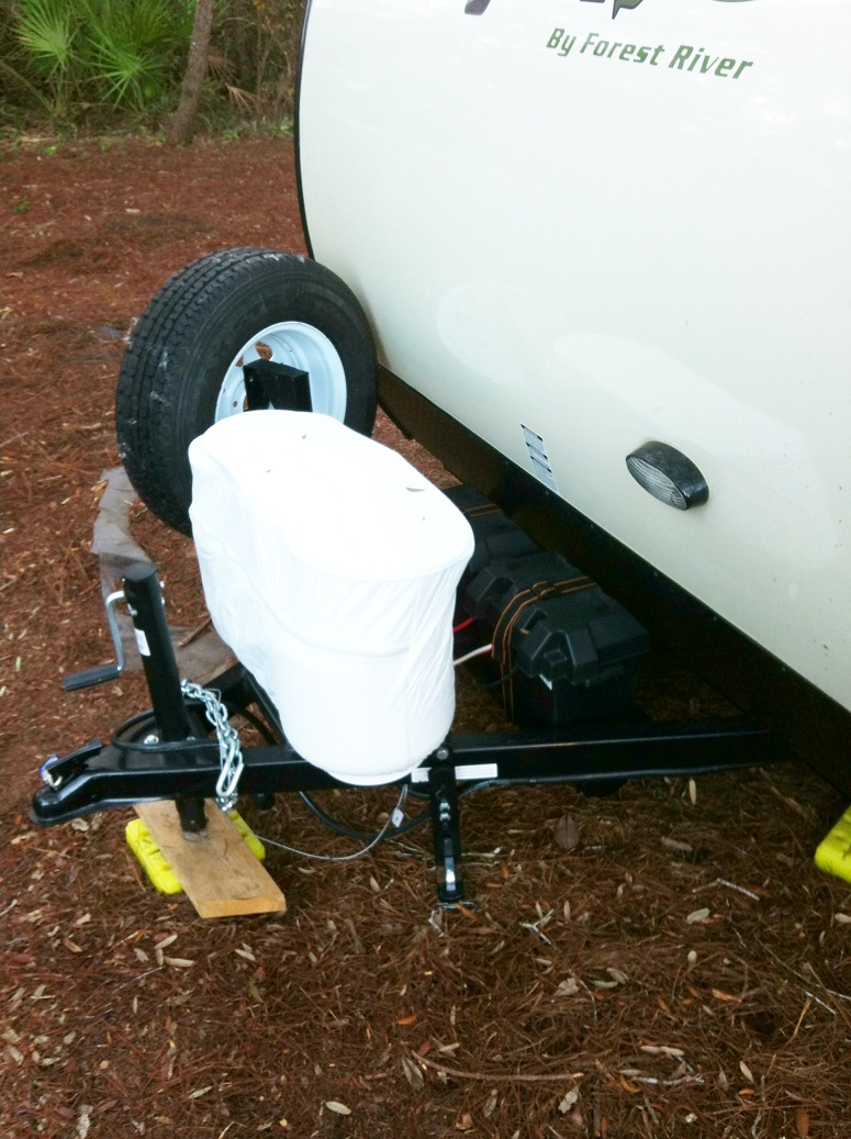

The results are shown below. The adapter just fits, but it
fits:
