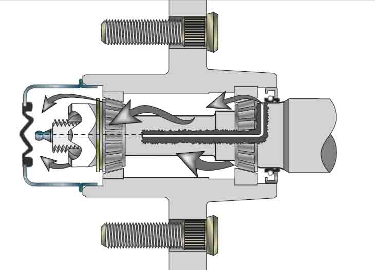

The Lippert axles have a 180 degree turnaround for greasing through the zerk fittings...extra grease supposedly exits the unit adjacent to the zerk.  The manual states that over-pumping of grease will  cause the grease to exit at the open end of the hub and not force grease through the seals on the inner face.
Does this mean that we are paying for a feature in the Lippert axles, which doesn't really work?

'Outbound' asked how can the grease get to the rear bearings of a SuperLube hub if the old grease comes out of the front bearings?  That is what the Zerk fitting is for.  Lippert axles sent me the engineering schematics for the SuperLub hub when I asked them the same question:
The hub has a central tube running from the zerk fitting into the rear of the hub where new grease is spread into the rear bearings and then forced around the central structure forward into the front bearings and then out towards the cup.

Thanks Tidalwave, I have wondered myself and this sure clears it up.

  Great job there TIDALWAVE of answering the question on how it works.  Thumbs Up   I still think that cleaning, a good inspection and repacking the bearings by hand for those that travel alot of miles evry year is wise.  Goose
