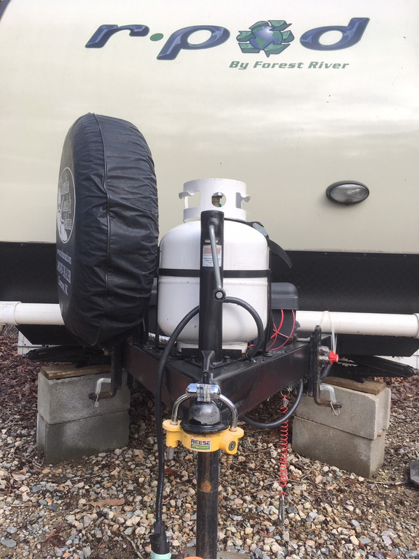

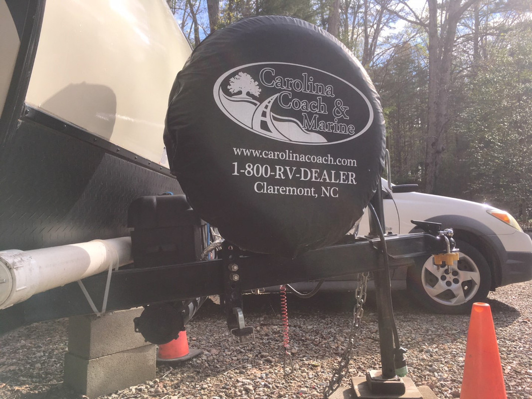

We took the spare tire off of the rear and mounted it on the passenger side of the A frame.  We had to cut the existing propane tank base off and move it as far forward as possible.  This allpowed to tire to snug up to the front edge curve of the pod body.
we used the existing spare tire bracket and cut off the bottom part that was ata 90 degree angle. Welded the vertical part directly to the side of the A frame
here are a few pictures
hope this helps
