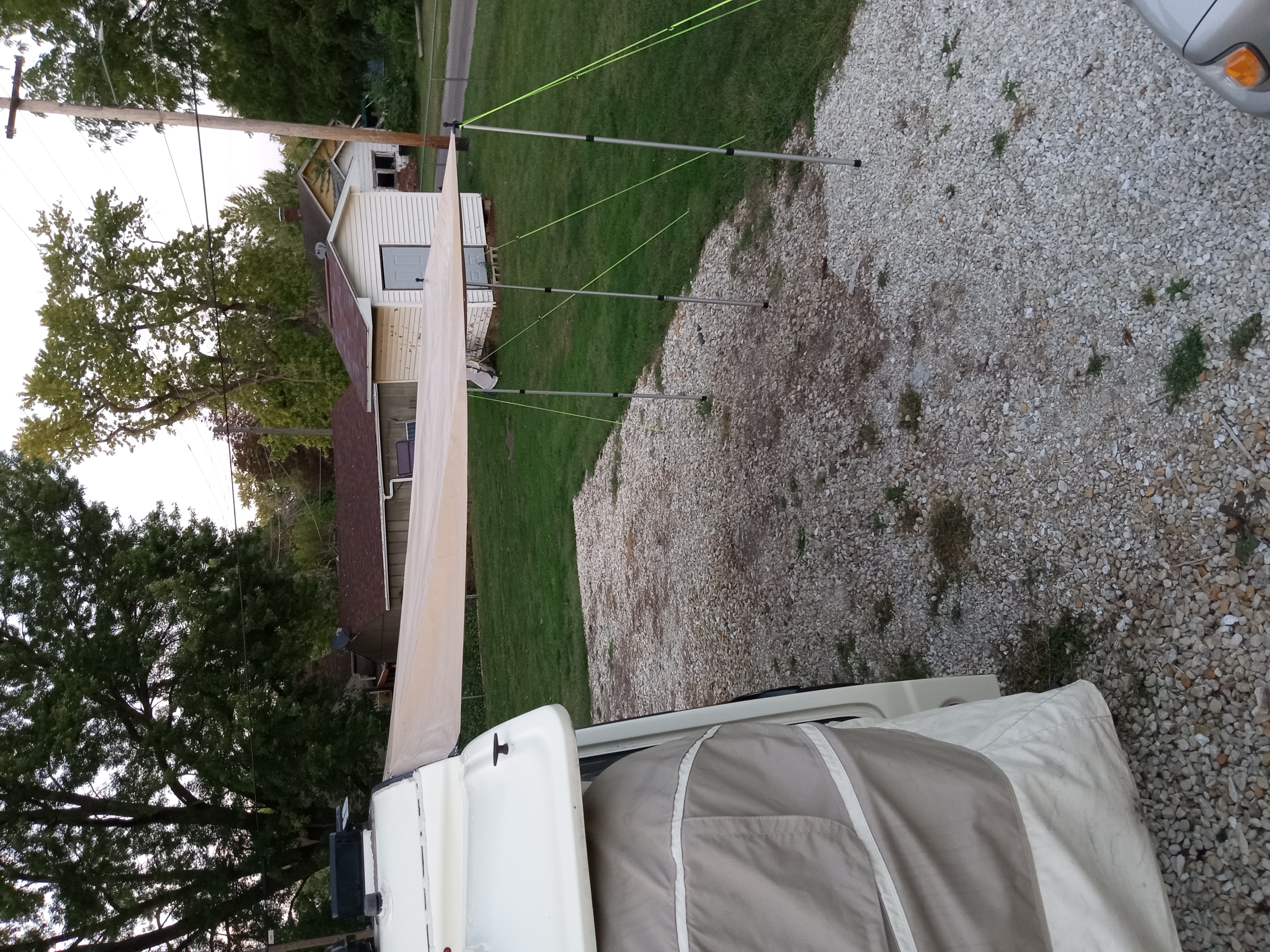

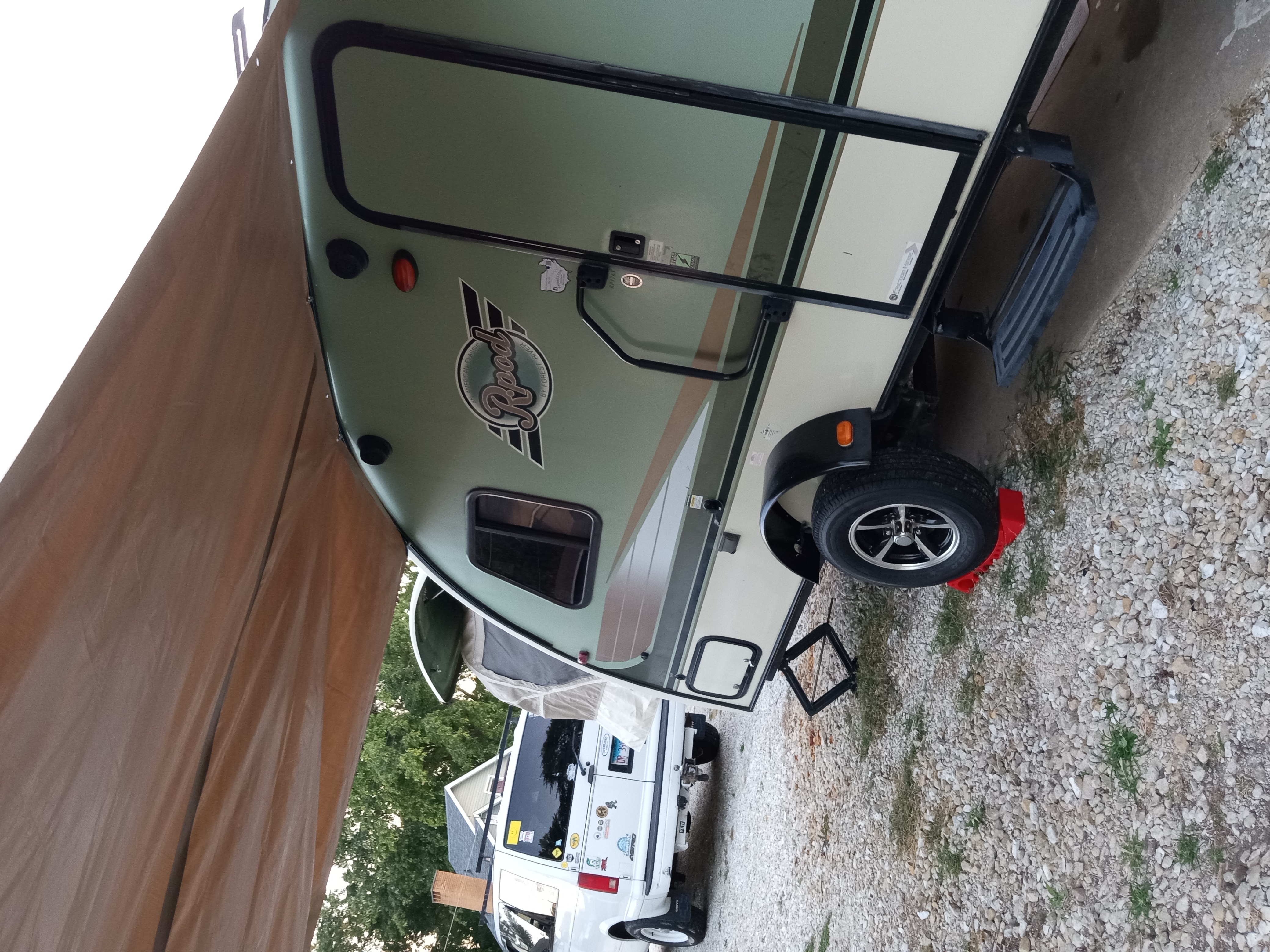

![]() this is a crappy pic of my homemade awning. its a 10x10 tan tarp, with homemade 5/16" machine screws slid into the track. |

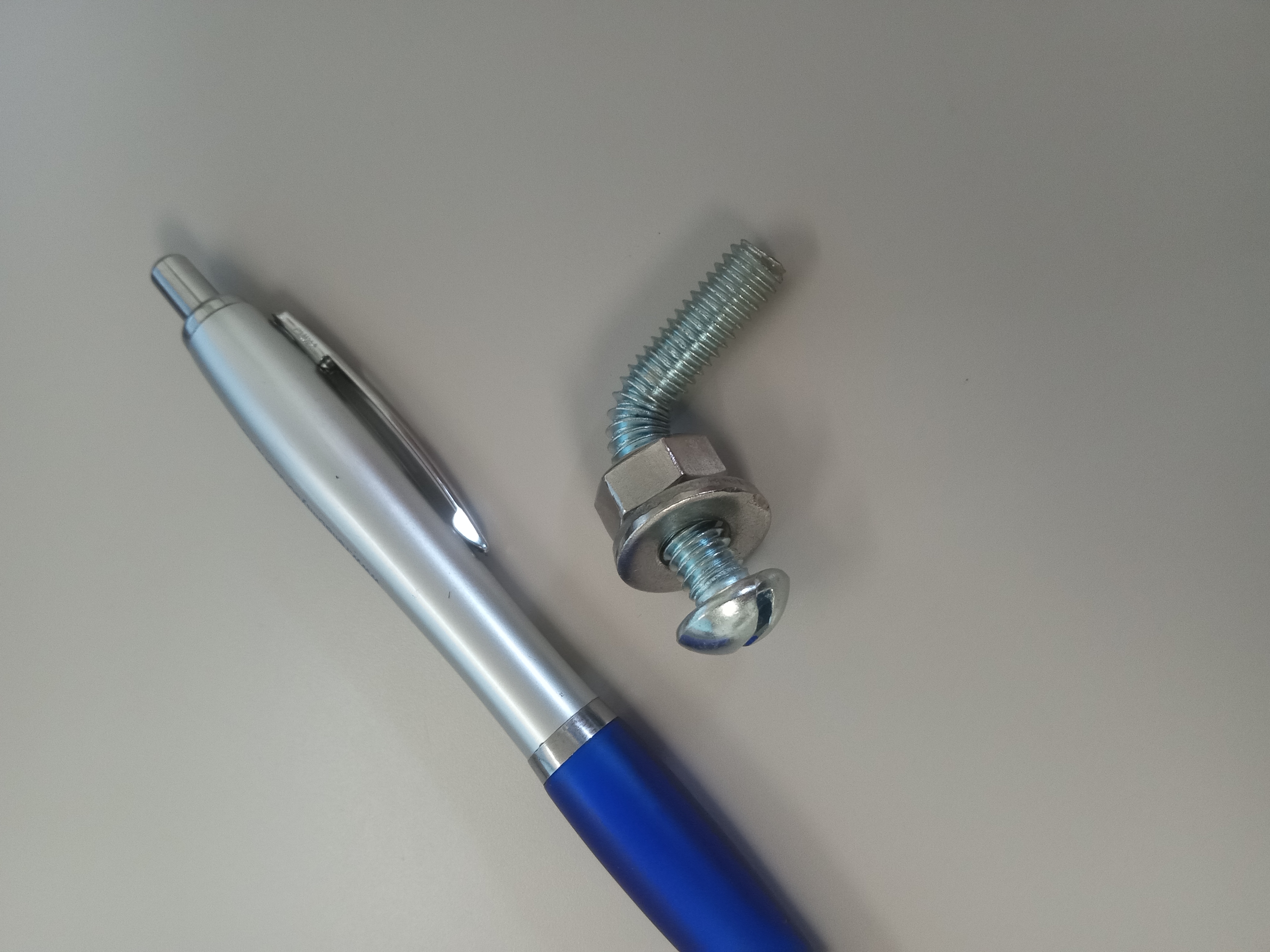

My attempts to use that track have been thwarted by the downspout interfering with the feed. Can you share your hardware design?

i'm uploading it now, my phone is super slow. but it is a 5/16" machine screw, 2"s long, i clamped the head in a vise, put a washer and nut almost all the way down, then tapped the screw over almost to a 90 degree. the head slides in the channel.

I ordered a medium duty tan tarp from Amazon. It only had 4 grommets on each side, so I ordered a grommet kit and made 5. One completely centered and then two were it starts to curve. Then on the ends. I bought 8' telescoping poles too. I had to add a grommet on the center of the pole side, I extended the center pole 8: and the two corner poles about 7' or so. It seems pretty good.
