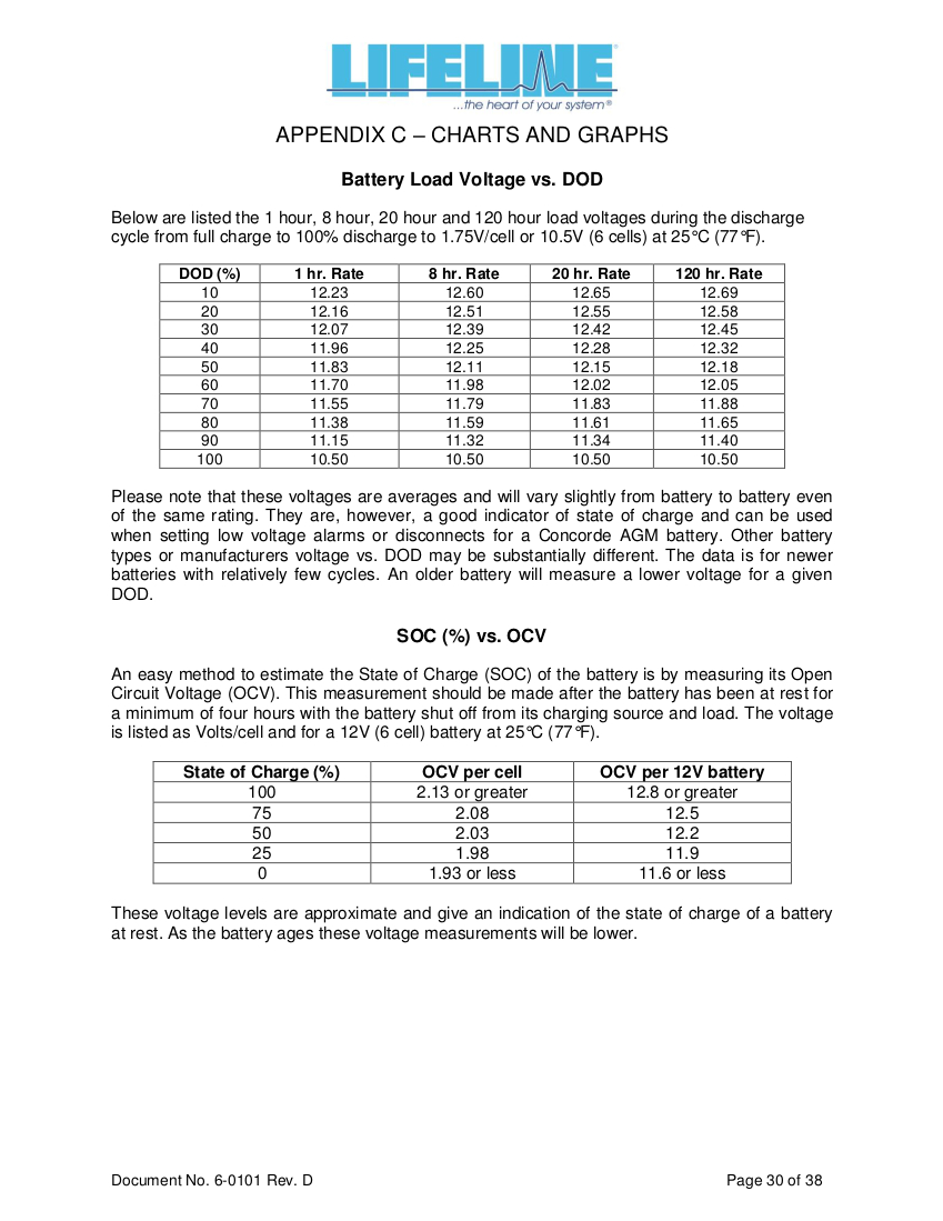

That was a disappointment to me as well.  I had hoped to have at least one plug powered on the battery.  In a 180, the plug under the dinette could be easily repowered with an inverter under the seat, behind the power panel.  It would, of course be very limited in the power available.  A 300 watt inverter could pull the battery down to 50% in 1.5 hours.
Attached is a handy SOC vs Voltage chart for flooded cells.
