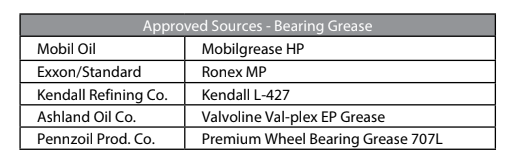

Assuming your axle looks like mine (zerk fitting hiding behind a rubber plug in the middle of the hub) here's the procedure.
My Lippert suspension manual suggests every 12 months/36,000 miles.  You'll need to jack up the side and remove the wheel to get to the hub.
I've just determined that this is my hub and I'm evaluating the grease gun & grease. I think which grease to buy is more of the issue. The manual basically says "Add more of the kind that's there, don't mix types without cleaning out the old grease" but also has specific grease recommendations.
