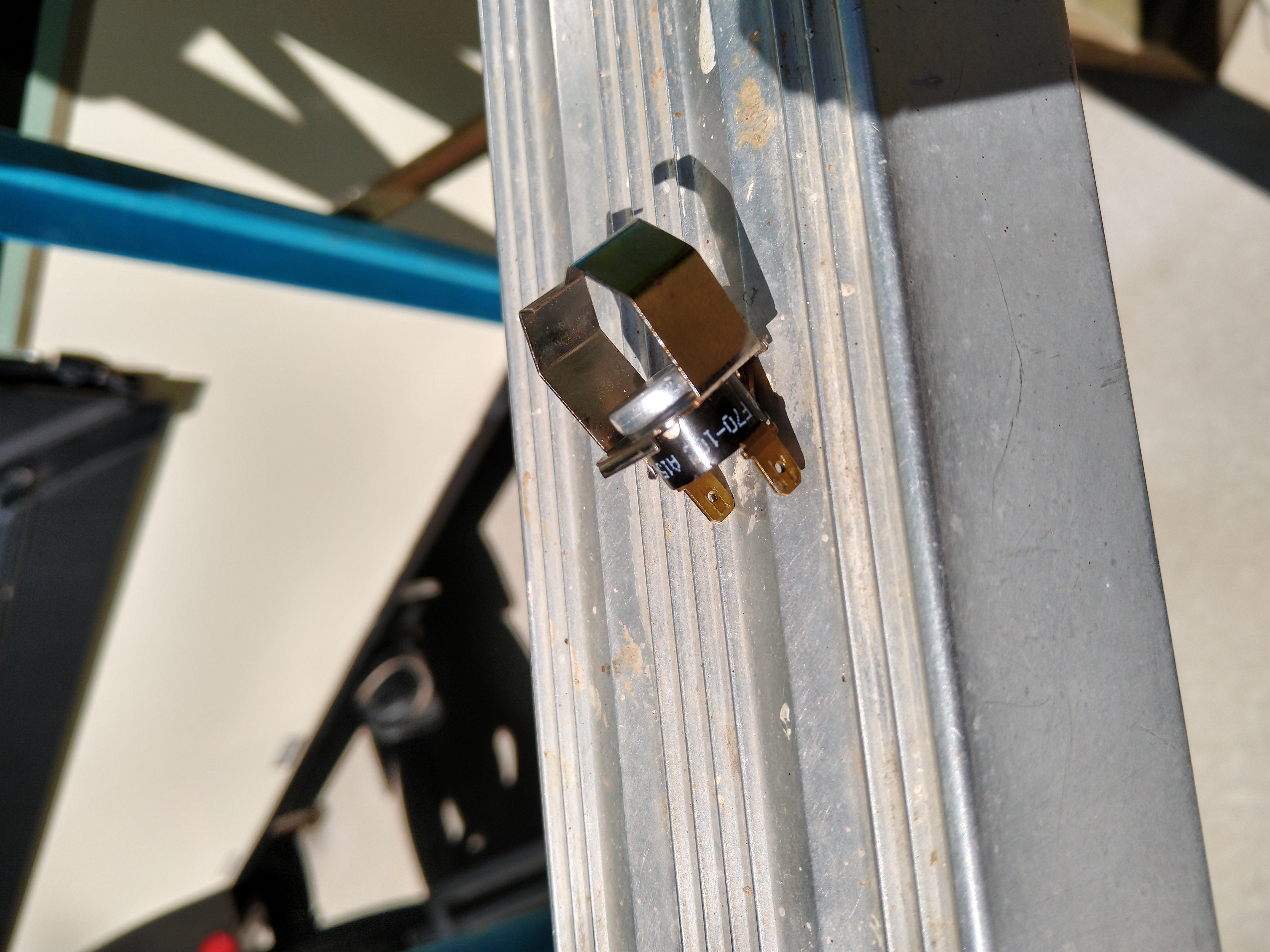

Hello All, looking for a bit of help here, I have noticed over time and in very hot weather my 8501 fridge will not cool as it should, found that the cooling fan in the back has never worked. I removed the fan tested to 12 v works ok tested the wires to all and they have continuity, so this leaves the bi-metal switch, removed it and tested for continuity after heating up no no avail. After heating and moving to a cooler temp I could hear the click of the switch returning to a open position. I suspect the problem is the switch. Problem I have is sourcing a new switch, any ideas here? Local RV dealer no help for parts

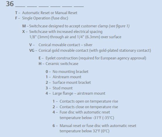

Found after doing some research and probably way too much info for a simple device.  For my 2017 179 year Dometic 8501 refrigerator the Thermostat thermal bi-metal switch numbers are  36TXE32-14582 F70-10C A1541.  The brand of the device (although not identified on the switch) is  Therm-O-Disc by Emerson.   The numbers  are as follows:
https://climate.emerson.com/documents/bimetal-36t-section-en-us-5469058.pdf
so this is a Automatic reset switch with a switchcase design, eyelet construction, stud mount with the contacts closing on temp rise.
I believe the  F70-10C  indicates that the contacts close at 70 degrees (then turns on the fan) and will reopen when the temp falls to 60 degrees (-10C).  This seems very low closing the contacts and return to open at 60 degrees  which if working correctly would run the fan most of the time.  I like the idea of the switch you mentioned,  it will close at 100 and open at 85  although I am not sure what the "normal" temp range of the pipes near the cooling fins would normally run at.   Any idea?

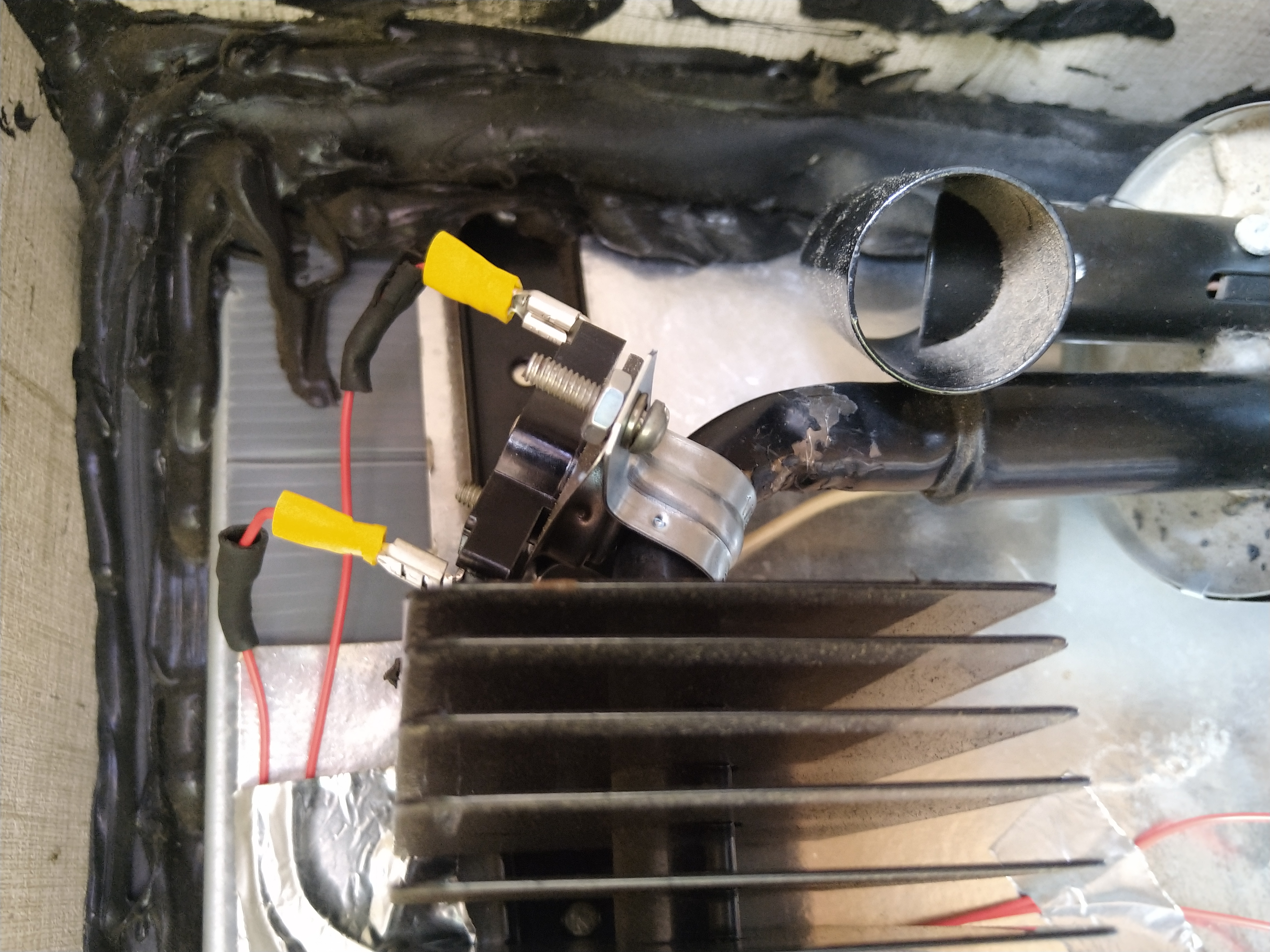

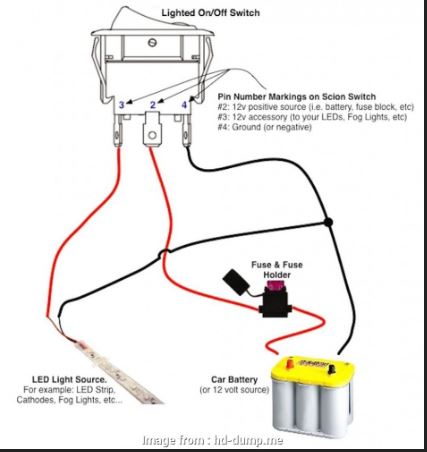

The last pic will show the thermal disc purchased from Amazon  100 degree closed  opens at 85 degree
https://www.amazon.com/dp/B019VSPFGA?psc=1&ref=ppx_yo2ov_dt_b_product_details  attached using the original wires,  had to change the spade connector size.  Now the fan will turn on at 100 degrees.  One spade connx is to power and  the other to the controller.   Interesting the fan will run even when the refrigerator is powered off,  not sure if this is standard since I do not know if the fan has ever worked.   I was hoping the controller will signal when the fridge is on to then look for the thermal switch to do its work to turn on the fan.  Anyone know if this normal?

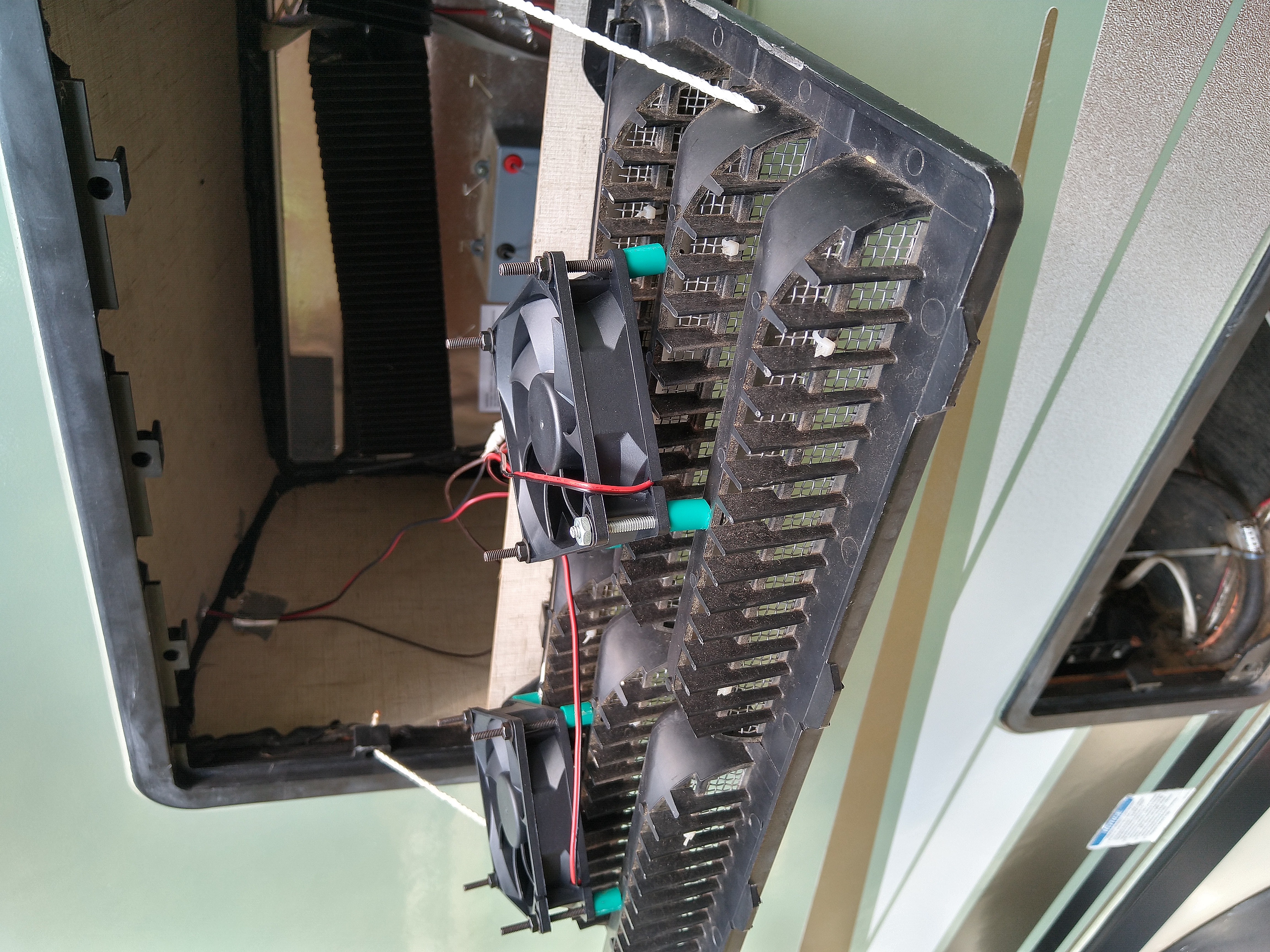

Added two muffin fans
https://www.amazon.com/dp/B08VHT6RVP?psc=1&ref=ppx_yo2ov_dt_b_product_details

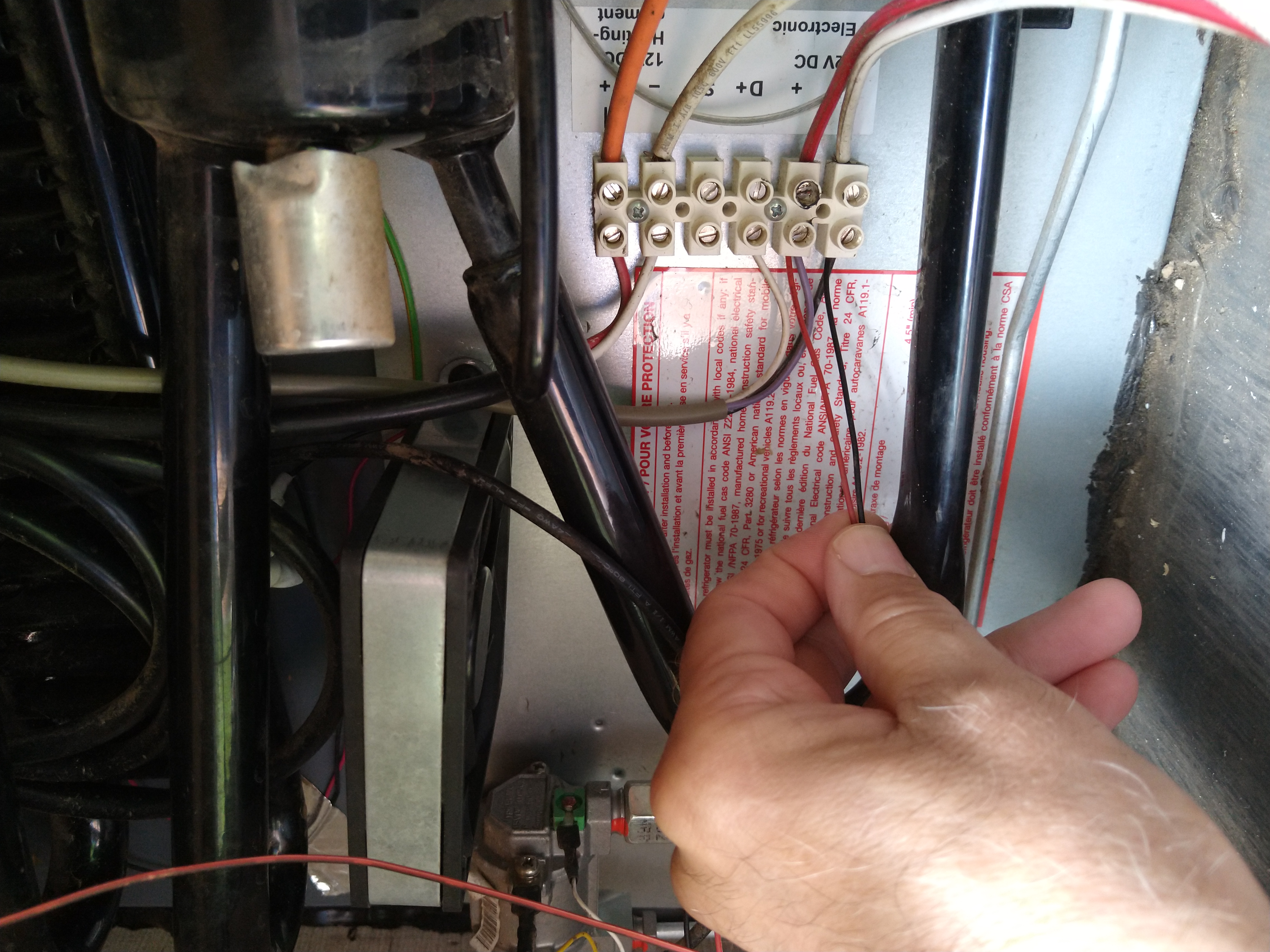

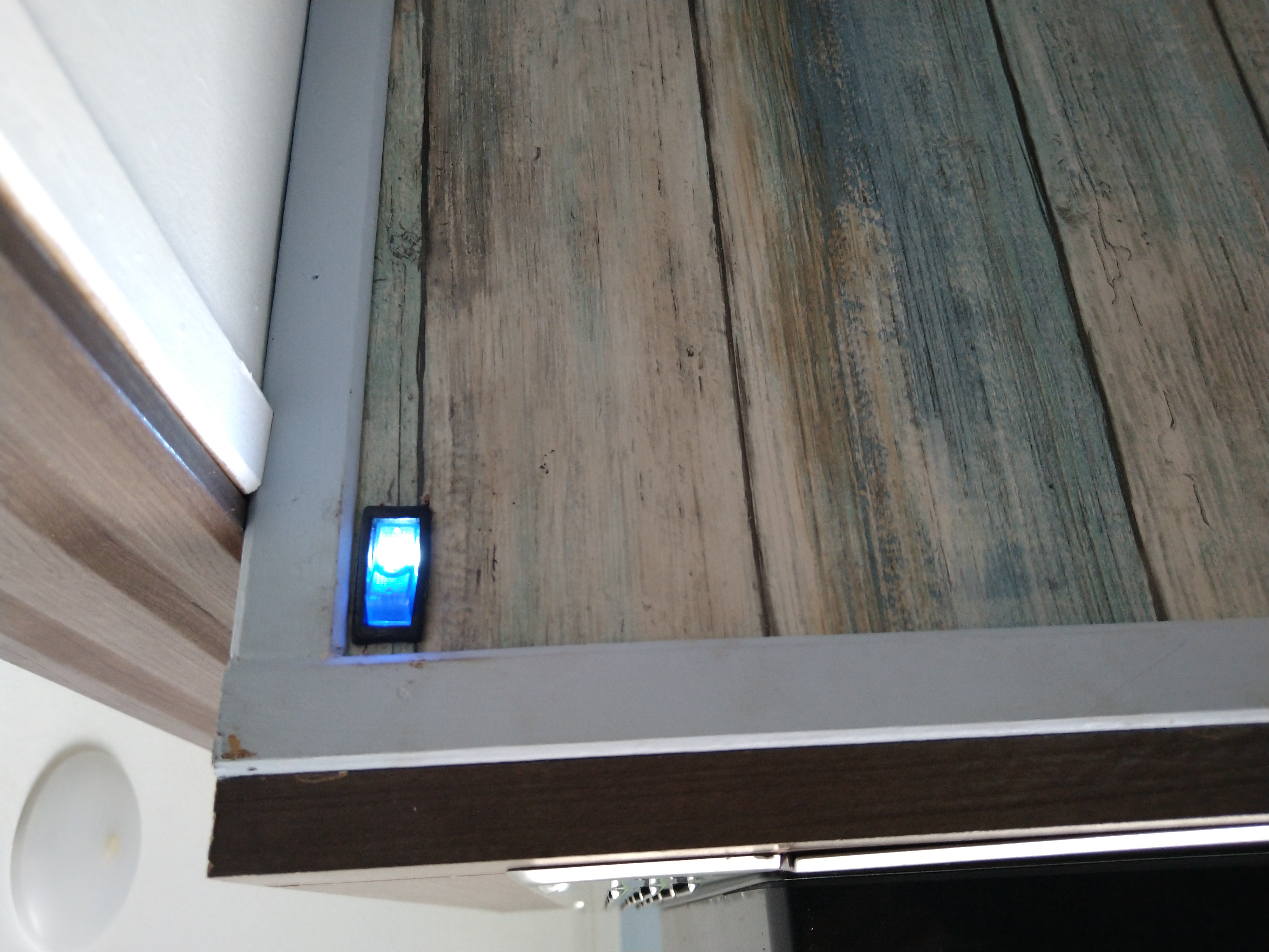

attached them to the connect block as shown  then added a manual rocker switch installed in the pod to turn on the fans (see the wiring diagram for the switch).

That looks like a nice job overall.  I agree that it is surprising that the fans come on even with the refrig powered off-I'm pretty sure that I have never heard our fans come on if the refrig was off.  but, there is probably very little parasitic power drain from the fans so it should not be a big issue.
I wired 2 additional fans to the original wiring controlled by the thermoswitch and they(both original and added fans) all come on/off at the same time.  since you added  a separate manual switch for the additional fans, they are not controlled by the thermoswitch.  so there is no connection between the 2 new, manually operated fans and the original fan operated by the thermoswitch.
Perhaps the original fan wiring has an interface that only allows the fan to run when there is power to the fridge.????? but there is always power available (even if not used) to the refrig whether on shore power or battery.  so that doesn't make total sense either. It would have to be connected with the refrig motherboard in order to "know" that the refrig was actually in operation and for the fans to turn on when temp is reached.
the fact that the original fan will come on without  the refrig being used is a mystery to me.  do you recall it working that way before the installation of the new thermoswitch?
In our first pod(173) I added 2 fans and direct wired them to a switch just as you did.  They were totally manual and not connected to a thermo switch, so were totally independent from the original fan controlled by the thermoswitch.  so, your install is approiate. However, if you want them to be controlled rather than manual, you could wire the new fans in series with the original fan/wiring.
either way, the idea is to keep the back recess as cool as possible.
