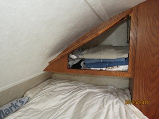

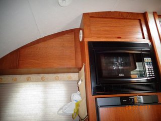

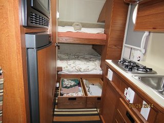

I have built many cabinets in our 172 none of them fell down. <a href='https://postimages.org/' target='_blank'><img src='https://i.postimg.cc/ht1sKpFC/IMG-0653-2016-09-23-17-45-07-UTC.jpg' border='0' alt='IMG-0653-2016-09-23-17-45-07-UTC'/></a> |
