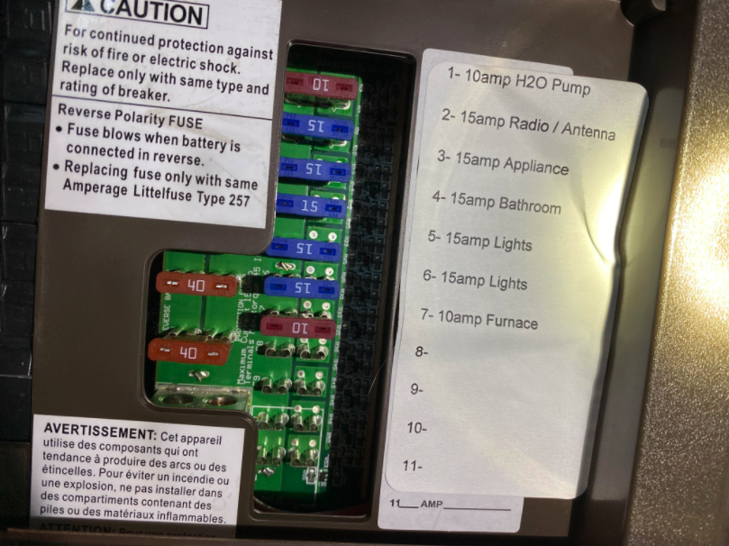

As far as adding the circuit to the fuse box, does it matter which extra slot in the fuse box I use? There are quite a few open spots:
Direct Link To This Post Posted: 21 Sep 2021 at 11:46am
Shouldn't matter. Of course, you should use your multimeter to be sure you have 12v to that fuse location.
