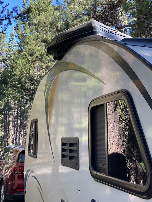

![]() Driving up to Loon Lake CA, the nearside wheel of our 171 went over the edge of the road with an almighty bump. On arriving at the campground the host checked us in but remarked "you may want to check out your A/C unit." Turns out that of the 3(!) bolts holding it in place 2 had sheared and one had simply pulled out. The only thing keeping the unit on the roof was the wiring. Then began a long saga. FYI Loon Lake is 25 miles up a winding road with no cell service. Our savior was camp employee hero of the moment Les who not only went down to the nearest hardware store for new bolts but fixed the unit back on much better than our !@$#⁄⁄!! dealer had done in the first place... WARNING these units are not directly attached to the roof but only to the inside part of the unit. Thus they are held in place by pure friction generated by the bolts being tight enough.. one breaks, the rest follow and the unit is free to go its own way. We were lucky!

Wow that’s crazy! I have an rpod172 and was working on the vents one day when a bolt head dropped down. I discovered by accident that one of the bolts had sheared off just as yours did. I have no idea how the unit didn’t leak through the roof. I replaced the sheared off bolt. I will assume the same thing, that they break when they bounce around on the logging roads. Three bolts is a lame design.

Before reading your post and observing the picture I thought, oh no lightning strike! Must be the shadows when pic was taken making that effect. I learned something new today about the A/C unit and how it is attached, thanks for sharing. Ordered our 177 back in January 2011 without the A/C unit (no regrets) and do enjoy the extra light that comes in through the roof where the A/C unit should have been.
