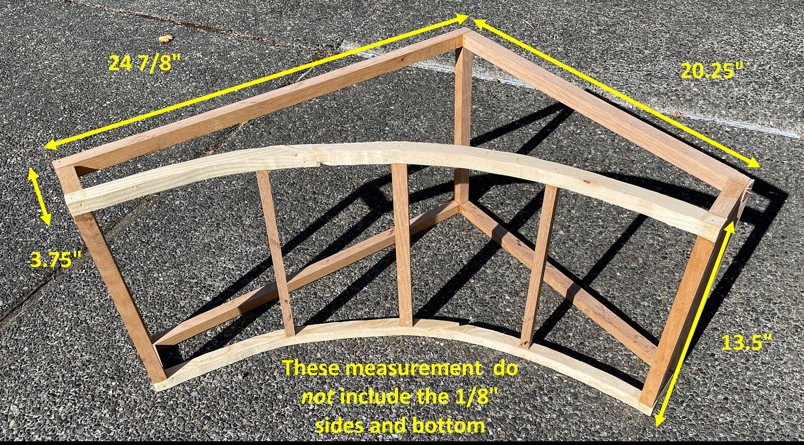

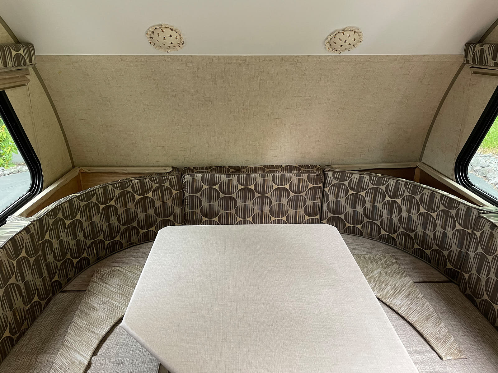

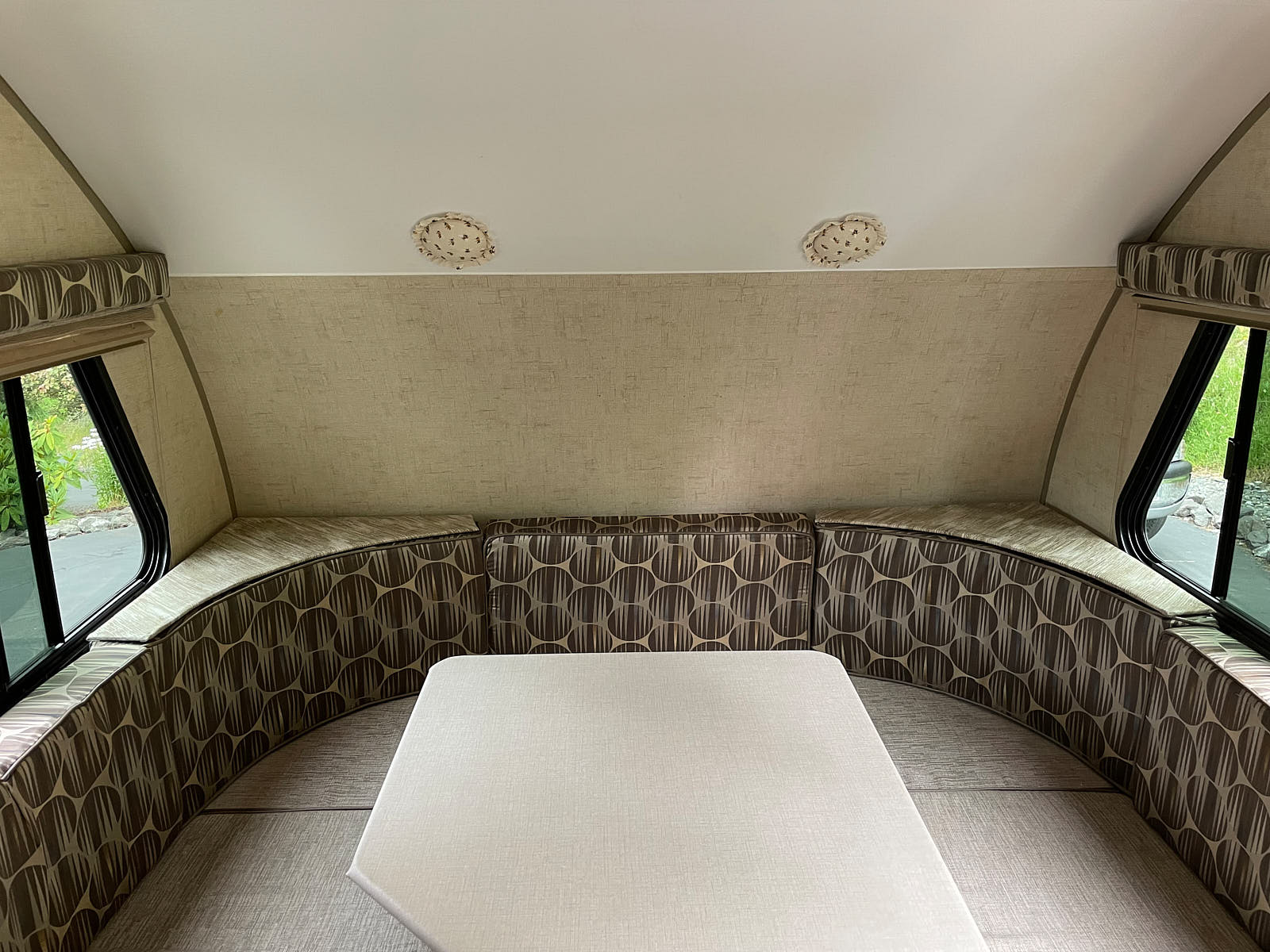

We have a 2017 R Pod 178 with the large table and corner cushions. We have only converted the table into an extra bed twice in 4 years and we thought that the corner cushions consumed a lost of space. So we converted them into storage bins.

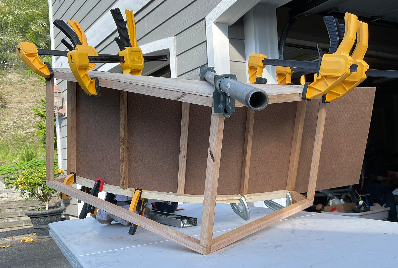

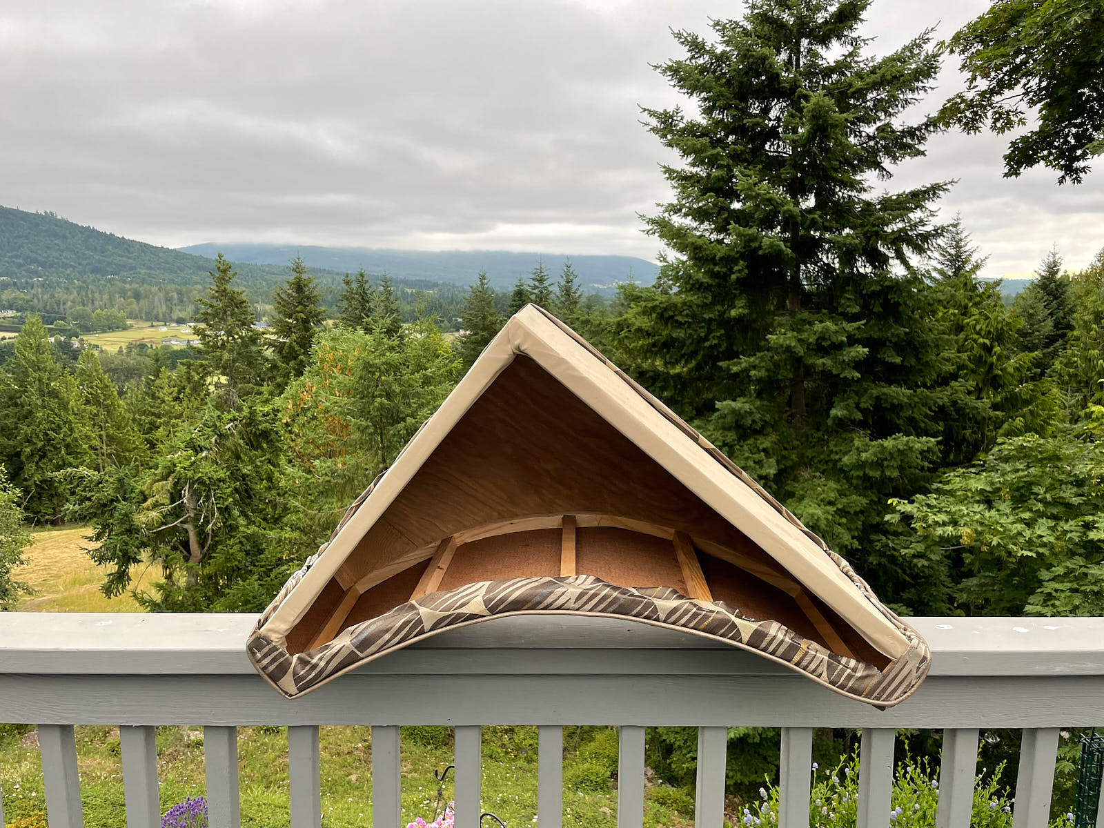

As you can see in the attached photos, the original fabric is still used and padding was added for comfort if you lean against the storage bin.
The attached photos include a diagram of the dimensions and the various stages of construction.
Let me know if you have any questions or suggestions.
