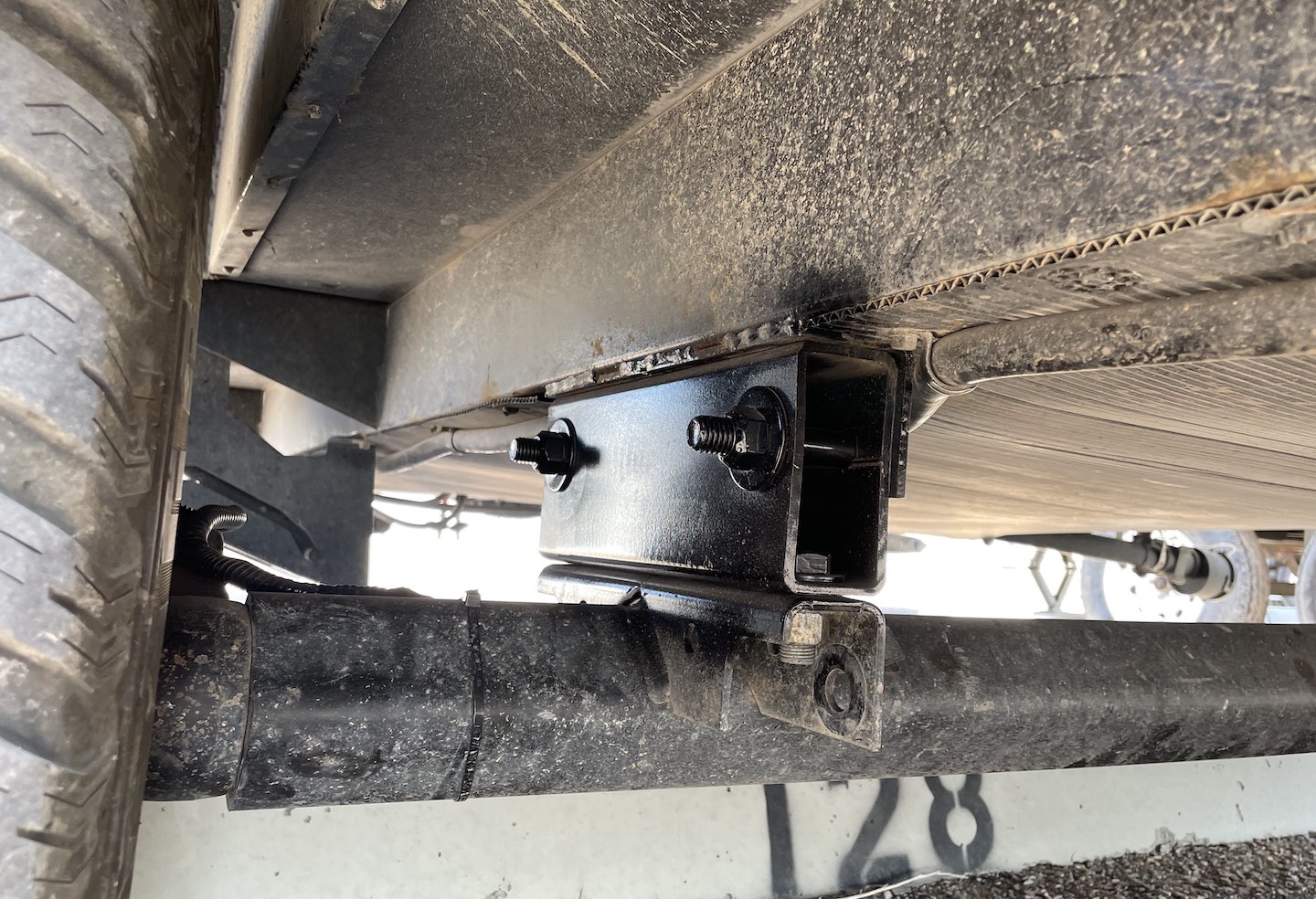

Direct Link To This Post Posted: 31 Aug 2021 at 4:42pm
Had a local welding shop add a lift to my RPod 196. This is a 2021 Hood River Edition which I thought came lifted, but it did not. They used tubular steel to make the lifts.
