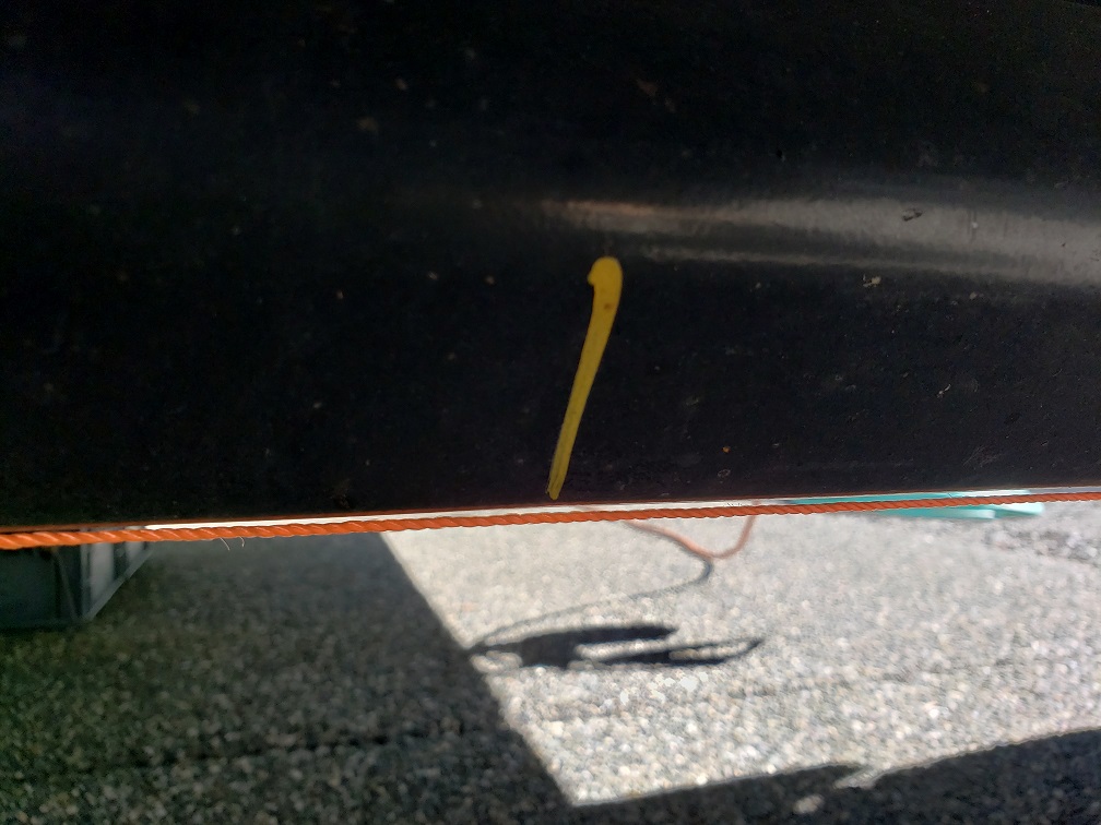

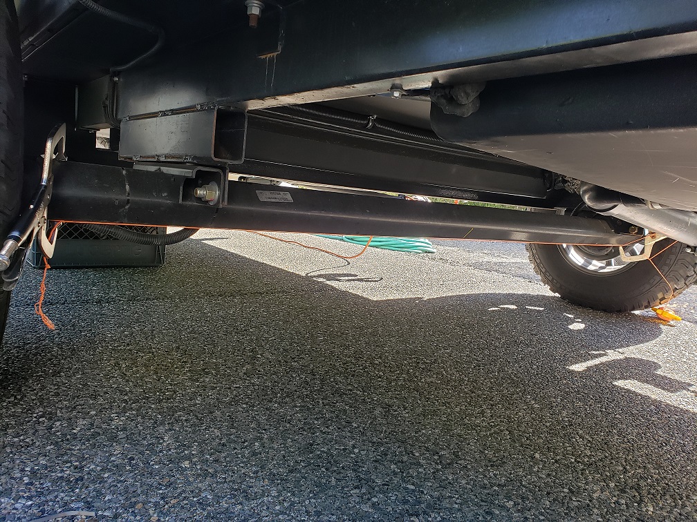

Both tires are 1" out of plumb...
A string line pulled tight across the axle shows only a 1/16" gap in the center...
My question is what is the best option of the solutions found here in the forum if there is no warranty help?

A 1/16" bow *up* in the middle could easily be inside manufacturing tolerances. Plus, a bow up in the middle would camber the tires out at the top, not in. A 1" positive camber on a 26" O.D. tire calculates a reasonable 2.2 deg pos camber. Are you sure something is bent? If so, it's not the center beam.

A 1/16" bow *up* in the middle could easily be inside manufacturing tolerances. Plus, a bow up in the middle would camber the tires out at the top, not in. A 1" positive camber on a 26" O.D. tire calculates a reasonable 2.2 deg pos camber. Are you sure something is bent? If so, it's not the center beam. |
Hmmm...I am definitely in negative camber per my pic so something is bent - 1" on the passenger 3/4" on the drivers. I thought the axle was supposed to be more 1/4" to 3/8" upward camber?
At any rate the dealer has contacted Lippert, sent me a request for more information (toe in/ toe out dimensions), and more photos.
I will be sending these in tomorrow. We will see...
Keith
The axles are shipped with a crown of around 3/16 inch at the center. They definitely flatten out when bent. That is because the loads at the cantilevered ends where the wheels are places an equal load on the axle along it's full length between the frame attachment points.
L0ots of discussion and analysis of this issue on this forum and elsewhere. Read the multiple threads on this topic from a couple years ago by myself and others.
Of course, it could Also be that the spindles are bent. A good trailer shopp will be able to evaluate.
