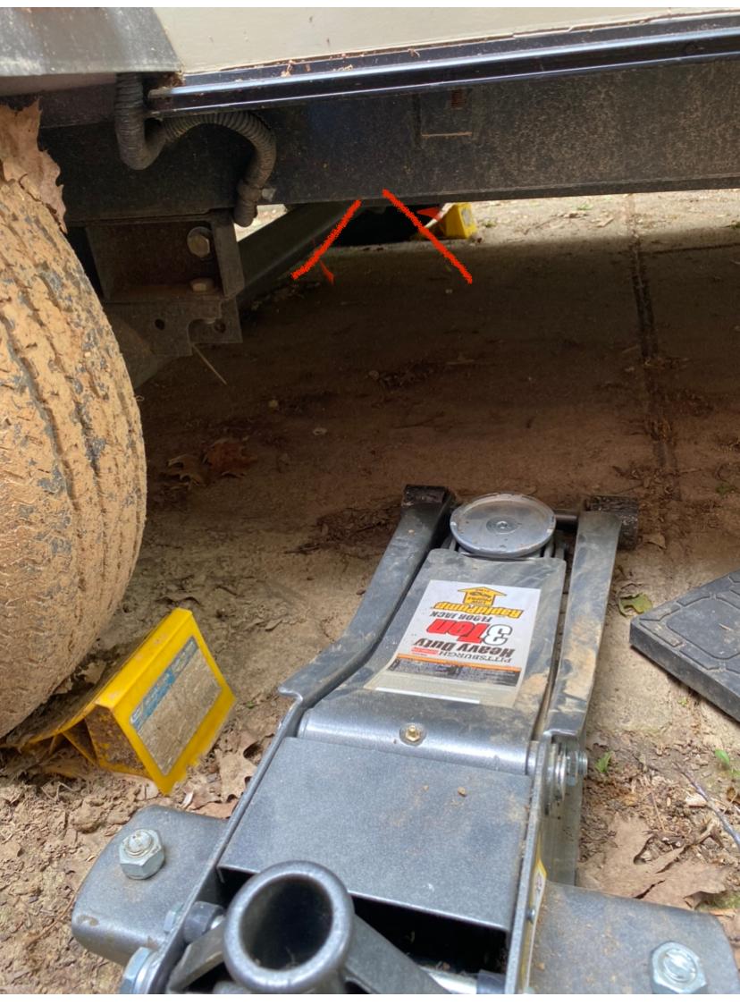

Hi folks. Does this pic raise any flags to anyone?  I've read through the many posts on this subject, but still would appreciate comments.  I'm planning on lifting by frame, and a couple vids I saw suggests lifting on the frame just "behind" the axle bracket. But I can't make that work on the one side because the steps are in the way.  So, anyone foresee issues lifting just in front of the back tire at where I put the red marks on the picture? Any red flags on the jack I using ?  Totally overthinking this I'm sure but first time you know.  Thanks for the thoughts

The frame is only 0.1 in thick. I wouldn't jack where you marked. See the vertical flanges where the axle it attached to the riser? Those vertical flanges are really strong because there is a lot of steel I'm the direction of the jack lifting force. That's where I lift mine.
In case it's not obvious leave the trailer attached to the tow vehicle eth the TV in gear and brake set.
