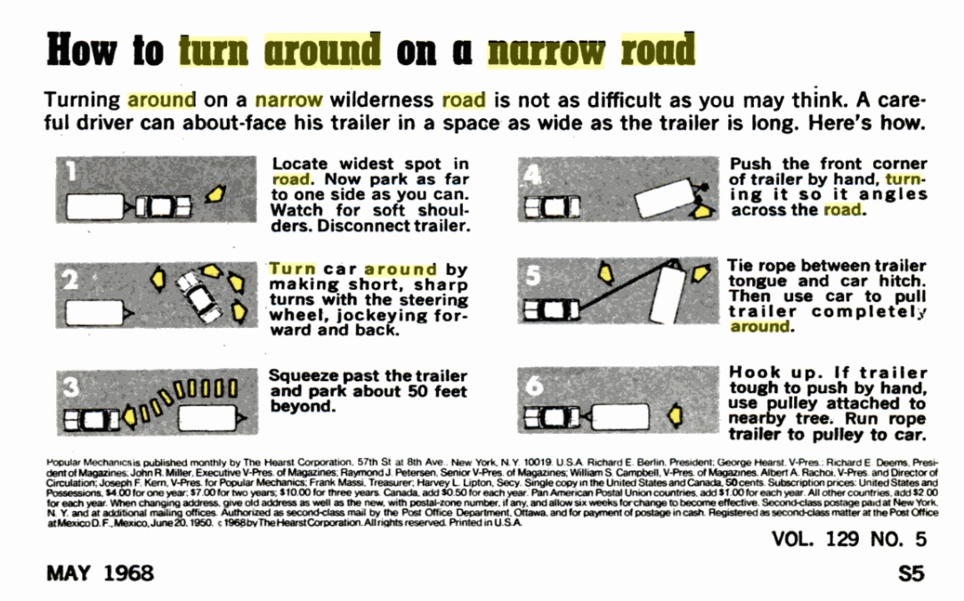

Would anybody consider doing it using this Popular Mechanics 1968 suggested method?

Direct Link To This Post Posted: 25 Apr 2021 at 9:26am
Image didn't make it the first time:
Uh, no.
It COULD be feasible IF it was a paved road, IF it was reasonably level, and IF you had a wheeled foot on your hitch or if it was light enough you could lift it by the hitch and move it.  But if it's that light, then while not just turn it manually?  Otherwise, I'd just back up to the last wide spot.  I think the scheme was intended for a relatively light utility trailer.
I have turned around a trailer where I couldn't just make a one-pass U-turn by disconnecting and reconnecting at an angle.
One thing I did glean from the image was that Pop Mech was $4.00 a year back in 1968!  It retails for $15/year now.  Wow.
Jim

Direct Link To This Post Posted: 25 Apr 2021 at 10:59am
Obviously, this would be an emergency only maneuver.  I'd think of moving weight from front to back to lighten the tongue weight, temporarily switch the foot to a swivel wheel (you can buy one for $15 and they attach with the quick release pin), and maybe use wheel chocks to control the rotation.  I have moved boats around a like this in the past by having somebody go stand on the swim ladder to get weight off the tongue.  It's something I might try with the camper in our driveway just to see if it's workable.

Direct Link To This Post Posted: 25 Apr 2021 at 1:16pm
We did this more than a few times traveling on back dirt roads in the U.P. of Michigan but had lightweight pop ups.  One was a 4 man 1982 Rockwood and the other a 6 man 1993 Jayco.  Both had a steel wheel that could be attached to the front jacking point, actually was more difficult to turn the car around as the road was one lane wide with sand and/or wet ditches on either side.
Being older, and hopefully wiser now, I think twice before going down an unknown road because there is no way to turn our 177 around that way, no wheel on the front jack and too heavy to move manually.

Direct Link To This Post Posted: 25 Apr 2021 at 1:59pm
I trapped myself at the end of a narrow dirt road that ended at a lake shore in the woods. To turn around I turned the steering wheel as far as it would go and backed just a few feet until the back of the rpod was almost hitting a tree. Then unhitcheded my pickup and turned it around and hitched the trailer back up with the pickup 90 degrees to the road.  pulled forward a few feet with the steering wheel turned all the way towards back down the road.and repeated the process again.  It onlly took about 10 minutes.

Direct Link To This Post Posted: 25 Apr 2021 at 5:25pm
+1 to Jato. Much easier and safer to walk the road if it's short enough or disconnect and drive the road first to scope turnarounds. Then reconnect and tow. If no turnaround presents itself then find somewhere else to camp.
