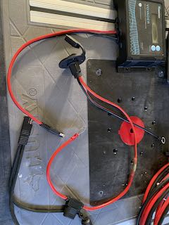

Sorry about pic. Not hooked up yet. Wire with SAE from controller. Plug in will b on battery case. Installing next week.

Direct Link To This Post Posted: 02 Apr 2021 at 9:24pm
  I'm not sure i understand the pict?

I built a 200 watt solar suitcase setup for my R-pod 196. Plan to use an SAE connector on the battery box with the wires attached to the battery - with a fuse on the positive. I will then have the solar suitcase connected to the charge controller and a male version of the SAE connector attached to the charge controller. I can just plug in when I set up.
