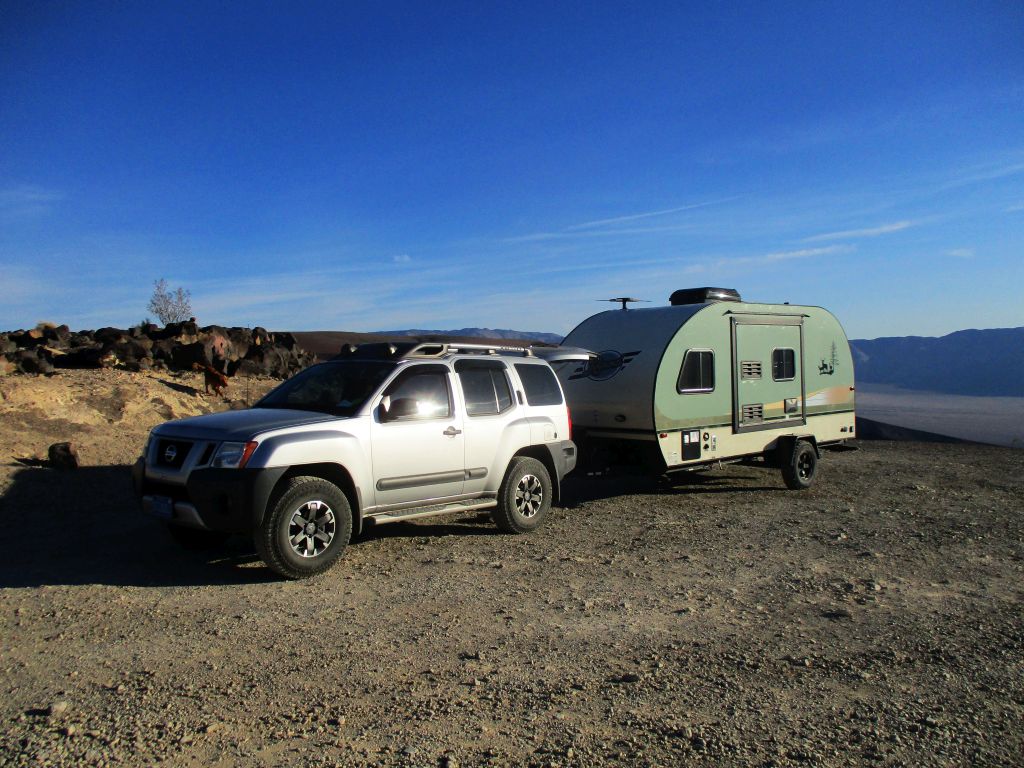

We have a 180 we tow with a 2015 Xterra Pro-4X with auto transmission, stock suspension.  We've gone around the country with it and are quite comfortable.  We love the compactness of the Xterra for off-roading and urban maneuvering and parking without the Rpod.
I find the Xterra to be twitchy on its own, and it's twitchy when towing.  I need to make a conscious effort to make smooth lane changes and not overcorrect.  The X's wheelbase is pretty short.  I think it's as short a vehicle you can tow an Rpod with, comfortably and safely.  We were just out with a friend in her Tesla X, and I thought it was a pretty small vehicle, but it's a foot-and-a-half longer than our X!
Gas mileage is terrible on the Xterra, and it's terribler when towing the pod.  But the X has enough power to get up most grades at 65 mph.
Right now, we tow with just a friction sway bar.  I'm moving to the Andersen weight distribution hitch though, to get more weight on the front tires.  The Xterra is prone to sag in the rear.  I added Firestone Sport Rite Air Helper Spring Bags, which have made a world of difference even without towing.
Our Rpod weighs 3500 lbs fully loaded for the road, with 480 on the hitch.  I wanted to stay below 80% of rated capacity.
Glad to answer any questions.
Here's a stop last month at Star Wars Canyon above Death Valley.
