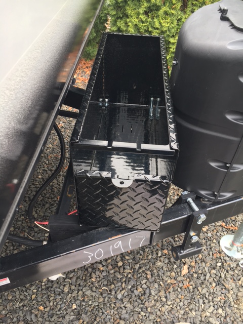

geewizard View Drop Down
Joined: 16 Apr 2017
Location: Spokane
Posts: 347
Direct Link To This Post Posted: 01 Jan 2021 at 11:39am
I bought a box from this guy for my two Group 27 deep cycle batteries.  Works well and fit across my tongue behind the propane tank without hassle.  And he is in Spokane.

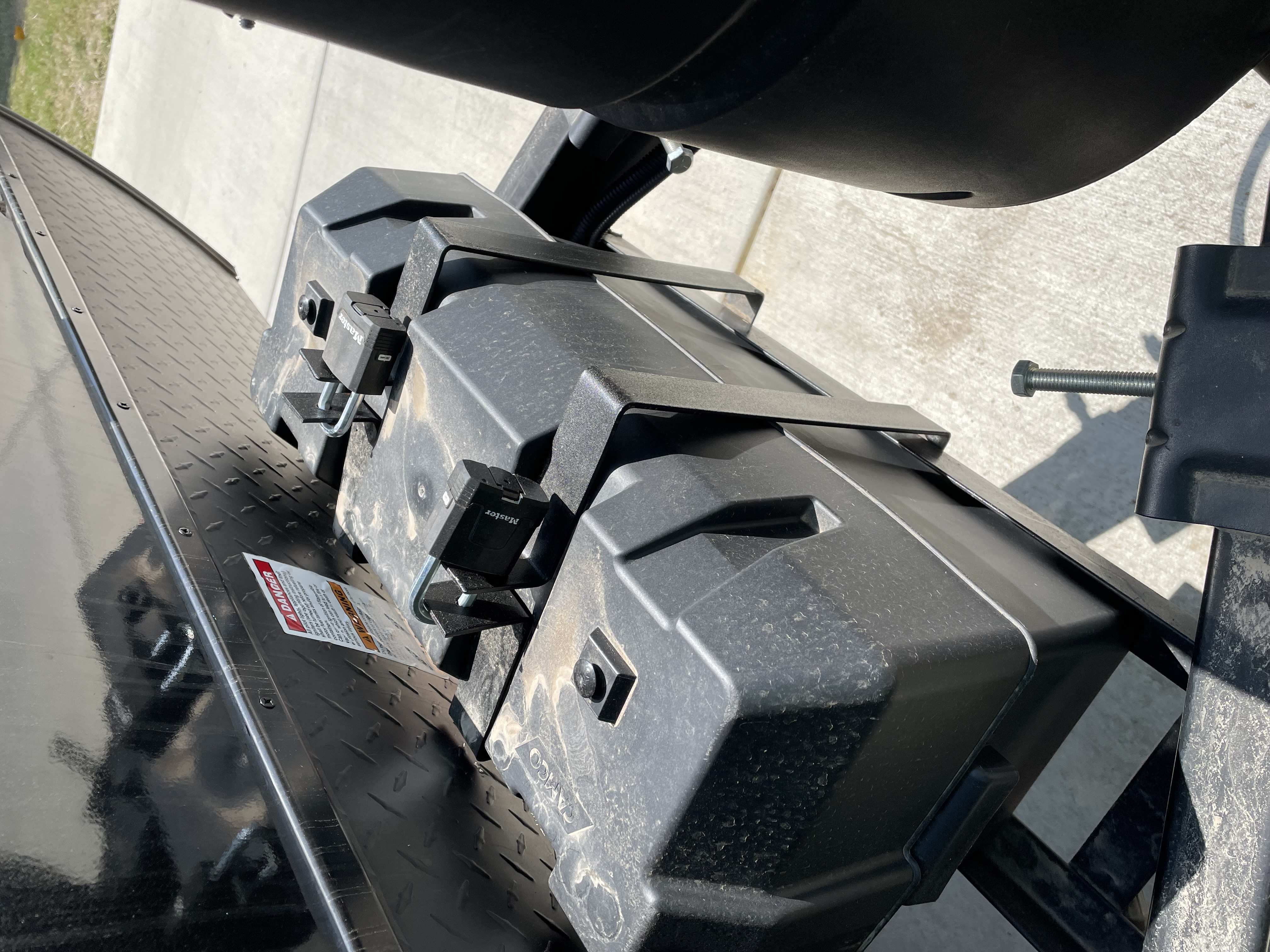

BH&MH View Drop Down
Joined: 25 Jun 2018
Posts: 9
Direct Link To This Post Posted: 18 Mar 2021 at 9:12pm
