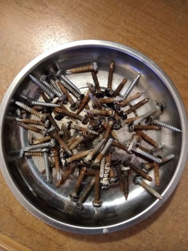

In 2019 I replaced the vinyl edge that covers the aluminum track and screws since the factory edge was cracking, (4 years old).  At the time I caulked over the screws of the aluminum channel thinking that there seemed to be no sealant from the factory for this edge except a bit of caulk next to the channel and the fiberglass roof.
Now in (Nov 2020)  I noticed some rusty water running down the walls in two places.   To resolve this I have now started to replace the screws and seal the Aluminum edge channels, per direction from a
Facebook contributor Doug Hanchett   (https://www.facebook.com/groups/56931970807/user/1348374207/)   an excellent posting!
He replaced the screws in the Aluminum channel, replaced the vinyl insert and then sealed the edges in EternaBond tape.  I am in the process of performing this mod/maintenance.  I have tackled the top of the pod first.  I replaced the factory screws with #10 Truss head Stainless screws and found many of the screws rusted,  some severely where they were not holding.
I debated if I should seal the edge with eternabond (or equivalent) tape and if I ever needed to get at the edge and could not come up with a reason, soo I went for it.  Top first and will finish all edges as time and  weather permits.   Pics are what I pulled from the top edges,  and a pic of a factory non rusted and rusted screw.  The bottom truss head screw is the replacement.  When I pulled out the screws, I pulled one at a time and replace one at a time  also added caulk to the screw.   Not a difficult job,  just takes time,   also I was fortunate in that I performed the most critical part during the cool weather,  in the heat i believe the butyl tape will be tough to work with since it is   very   sticky.
