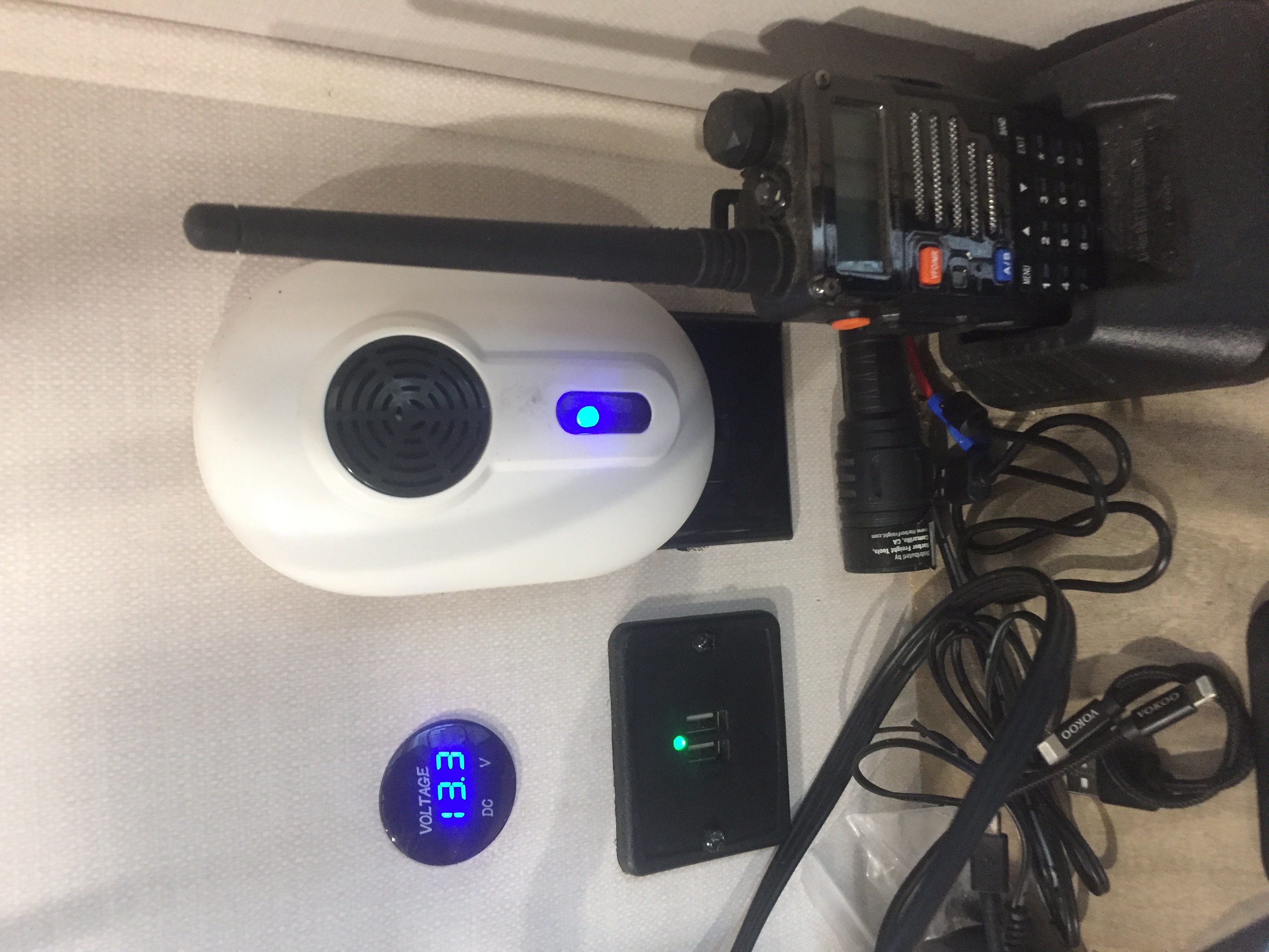

Ebay to the rescue. I can now tell how the battery is doing and when I have a major draw. You can also add USB outlets if you need them, but there are two already.
