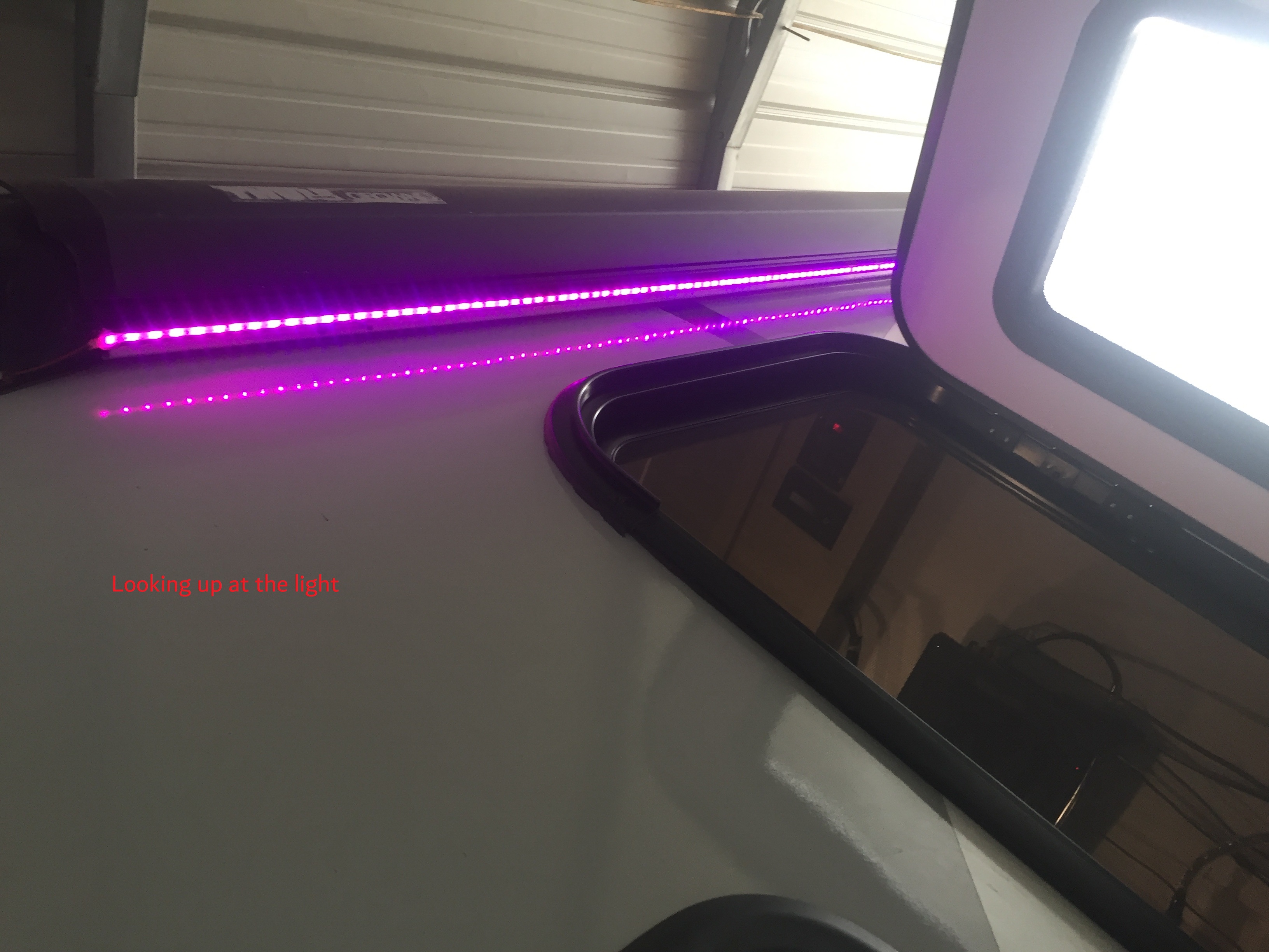

Couldn't take the white light strip they put in over the awning. Drew lots of bugs. You can slide out the strip and replace it as long as you can solder. The wires are easy to get at on top , just put lap sealant over the connections when your done. Choose your color. I went with purple pink for at night. but yellow is ok also. You can buy the 12vdc strip lighting on ebay or amazon in 25 ft roll, cut as you please. with scissors
