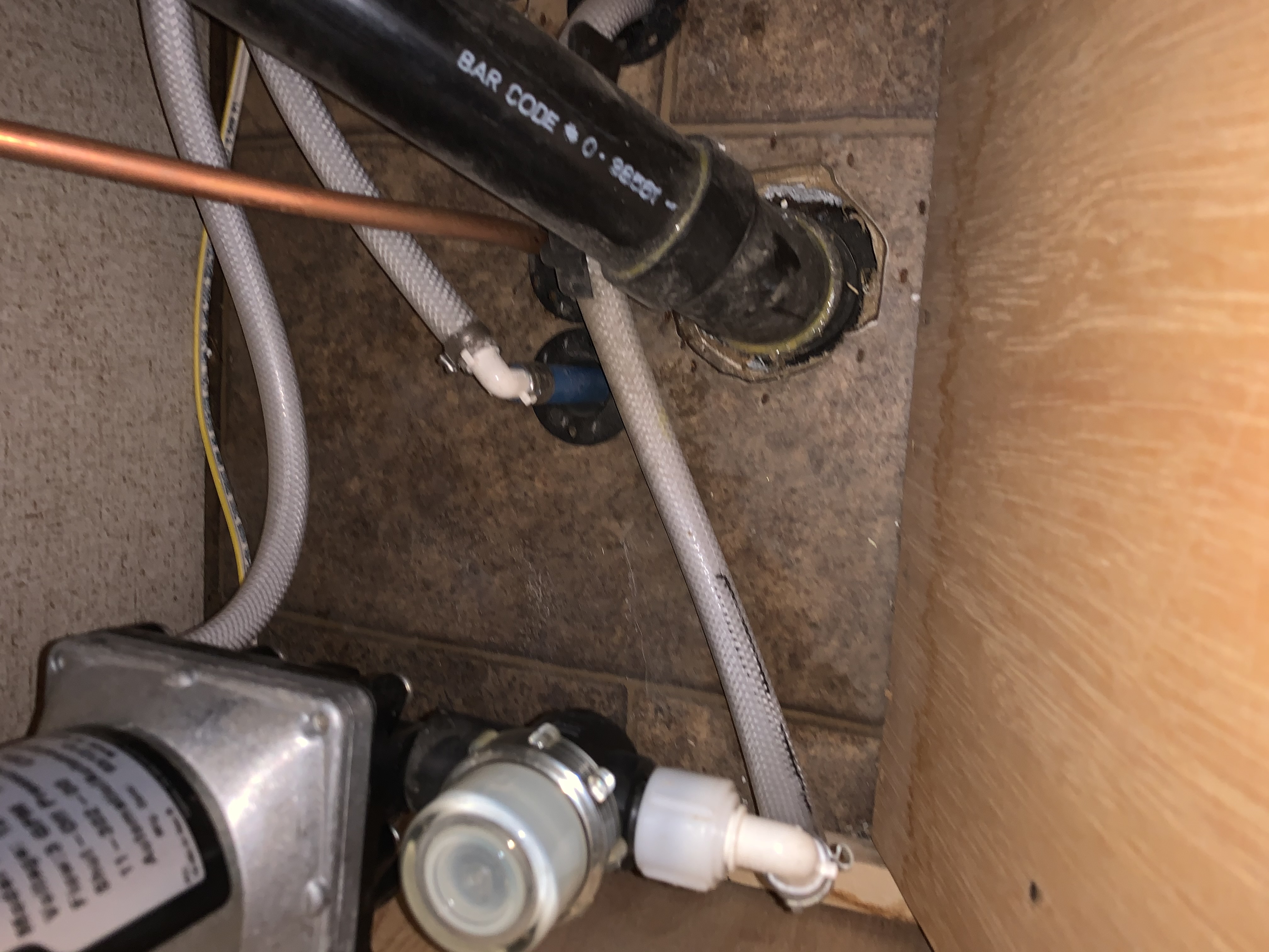

We recently bought a used (2014) RP-172 and are preparing for our first winterization. Following the great information on this forum, I have been looking for a valve and short loose hose near my pump to use an intake line for antifreeze. My pump is under our stove/sink. It looks like I do not have any T-connections, valves, or "loose" short intake hoses near my pump. There is just a solid white hose coming in and one going out.
I also looked near my water heater, which is under our bed. It has the three valve bypass setup, but there are no splits there either.
Does that mean that I have to unhook one of the white hoses connecting to our pump and connect a loose end short hose to it, in order to dip it into the antifreeze jug? If so, could you tell me what size hose and connection so that I can try to buy the right ones?
Would something like the "Camco Permanet Pump Converter Winterizing Kit" or a similar three-way valve with hose fit and do the job?

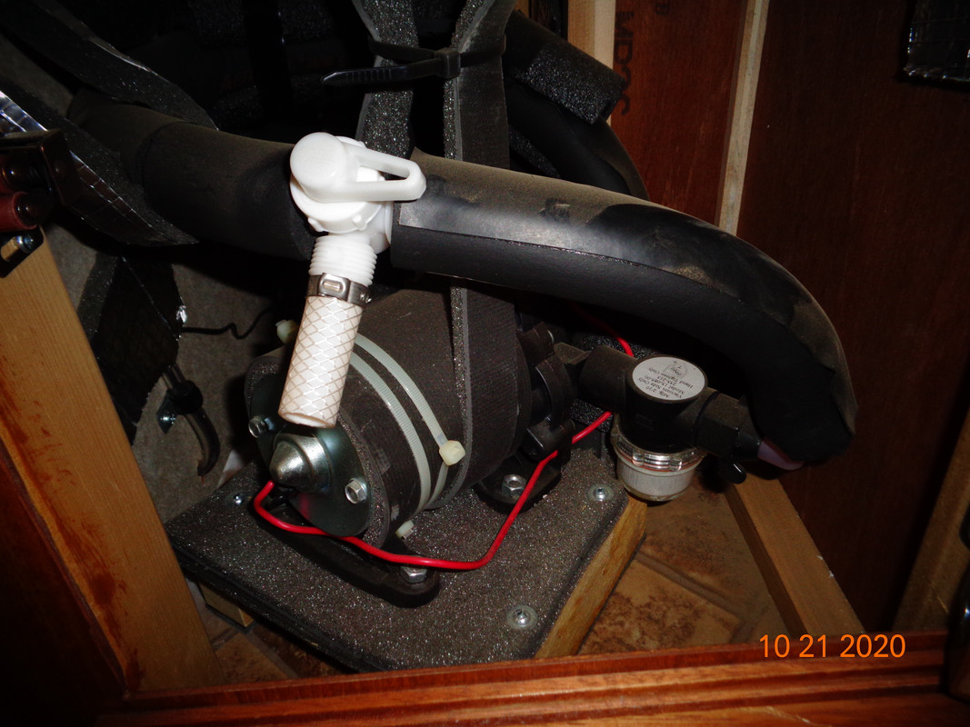

I have a 2011- 172 the short nipple is for the siphon hose

Thank you. There is no such valve or short piece on ours. It looks like they sell 3-way valves to install it ourselves on Amazon -- I might have to check if they fit.

Trace the line from the inlet filter back. Does it go straight to the floor (and tank below)? It should have a valve inline before the filter. On mine, the stub hose is much longer.
An alternative, if there is no stub hose and you don't want to cut the line, is to get a pump that attaches to the city water connection outside and pump it in from there. If you do that, take special care to make sure you run the pump until it is not drawing water (e.g. just pumping air), and then to remove and empty the strainer cup. That will help keep your pump from being damaged from freezing. Here are two options:
