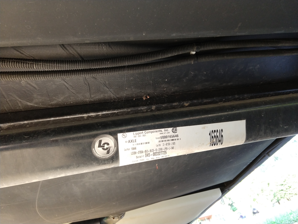

Thanks Steve. My sticker says 89.5 as well. Does this mean if there is an issue with camber and toe-in that the measurement would be different?

I believe the number in the third group (89.5 in the photo) is the axle length and the 4th group is the frame attachment dimension, but you should confirm.

Can you see labels on the current axle? If so, then those will have the information on the correct axle for your RPod. Here is an example:
