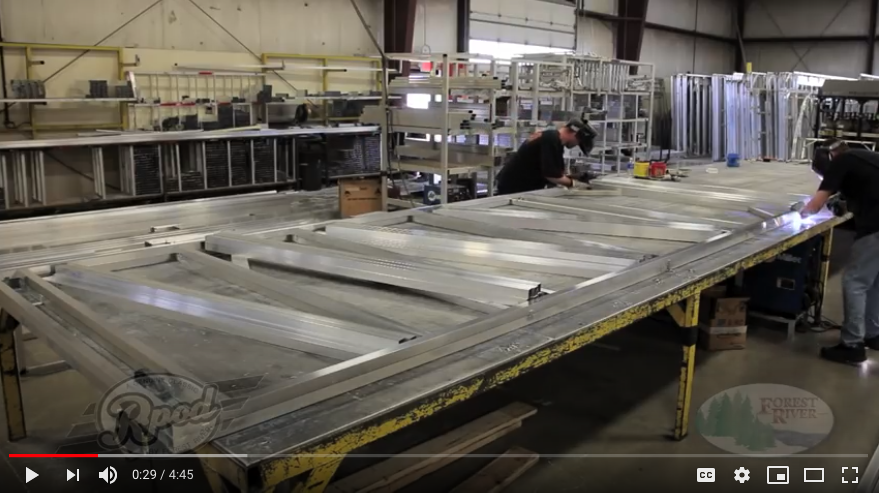

I'd get that outside wall jacked up and some jack stands under the wall. I would span the length in question with another support (I'd use some sq stock steel I have around) and at least a couple jacks (I would use my 3 bottle jacks) once up support with the jack stands. I won't do much messing around till that is supported, never know what else can occur.
A 2016 video shows a 2" sq stock aluminum floor frame. It will be interesting to learn if it's on yours and if it goes to the outside wall. My belief is it's a composite 'on' frame and explains the dropping away.
