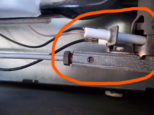

Yeah, I've tried to blow everything out.  Fridge works on 12V and Electric.  The igniter clicks and I can see the flame and then it goes out...it just won't stay lit.

If you go in back and open the panel, you should hear clicking. The h/w tank will make 3 attempts to light. With out getting to close (it's goes whoooosh if it lights) see if you smell propane. If you smell propane, it's probably an igniter problem. Might need a new igniter board. igniter board is less than 100 dollars on amazon

Next thing I'd try is vacuuming out the flue and gas orofice area. Diisconnect 12V from the fridge for awhile to reset and try again. If that doesn't work then you might try this manual.
