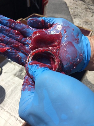

I only drove about 100 miles with the mixed greases after I learned all this about the greases not being compatible, so I decided it best to take off the hubs, clean out all the old grease and repack everything with fresh Red N Tacky #2. Watching videos online, some from RV dealers, it shows how to do it, pretty simple, just takes time, basic tools, new grease and lots of paper towels. The videos I watched all had the mechanic using a long flat tip screw driver to pop out the old seals. I have that…

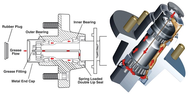

And I guess I should add this too - you read about getting grease in the brake assembly and people say "Don't use the Zerks, hand pack because the grease will blow past the seals and enter the brake assembly." Well there was NO grease in my brake drum area and I used the Zerks. For me the Zerk fittings functioned exactly as designed, so each type, age, seal condition, etc. of the trailer will vary. If the trailer is 15 years old, never had the seals changed and been in water, etc. no wonder they will leak.
I pumped new fresh grease in the Zerk while I had the hub off to clean out the tube where the grease goes in the spindle and comes out the base where the inner bearing sits. The grease comes out the hole slowly like a wiggly worm about the same speed it comes out the grease gun. Not at 10,000 psi to blow out the seals like you read in some places. The grease gun may be able to build up to 10,000 psi, but the path of least resistance will allow the fresh grease to travel through the system and back out the front. Again, on a clapped-out, 15 year old trailer that's been in water and has never been maintained, I can understand that failing.

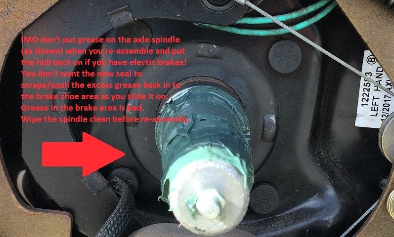

What would certainly put grease in the brake area though after I thought about it is if you put grease all over the axle spindle before you slide the newly packed hub assembly back on. The new seal is going to scrape and push any excess grease on the spindle toward the back on the outside of the seal lips as you slide it back on. That grease is now built up on the outside of the seal in the brake area.
It may not be enough to make a difference, but I don't want ANY grease back there that shouldn't be. It's my understanding that if the bearings are packed well that's the only area that needs grease.
